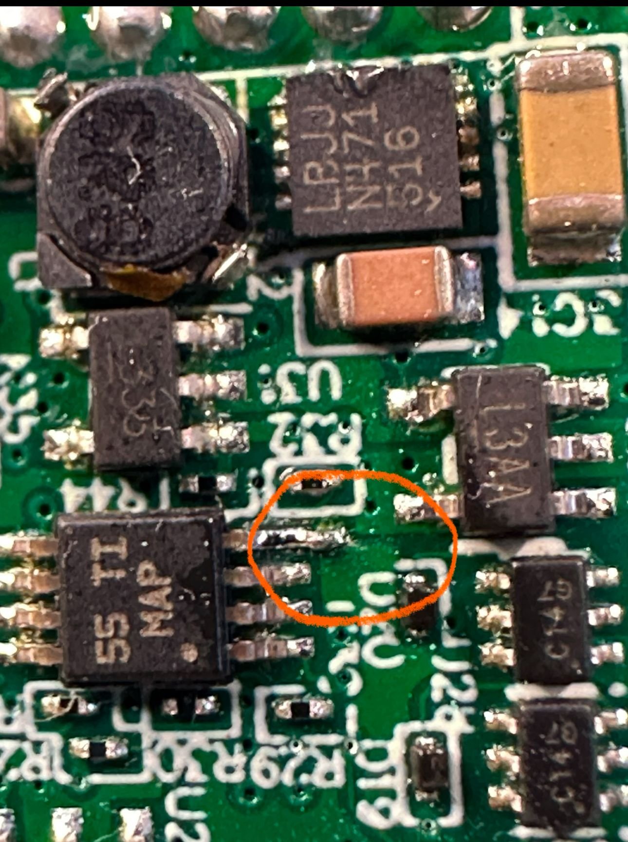

I do not understand what point on the board is consdered the "via" . please clarify. thank you

Finally I added the jumper to the via, I practised before I attempted it, when you see how small the jumper is in length it is a bit intimidating. I modified the tip of the iron, tinned the via and used a 28 AWG tinned copper wire. It ain't pretty but hopefully it will do the job. The jumper was L shaped for holding when it was fitted and trimmed flush when soldered in place.
If I can ask a question. Which specific point on the board that is being soldered to is considered the "via". I do not see a marking on the board with that name. thanks

Once the micropod is open, it’s literally a 30 second modification/repair
