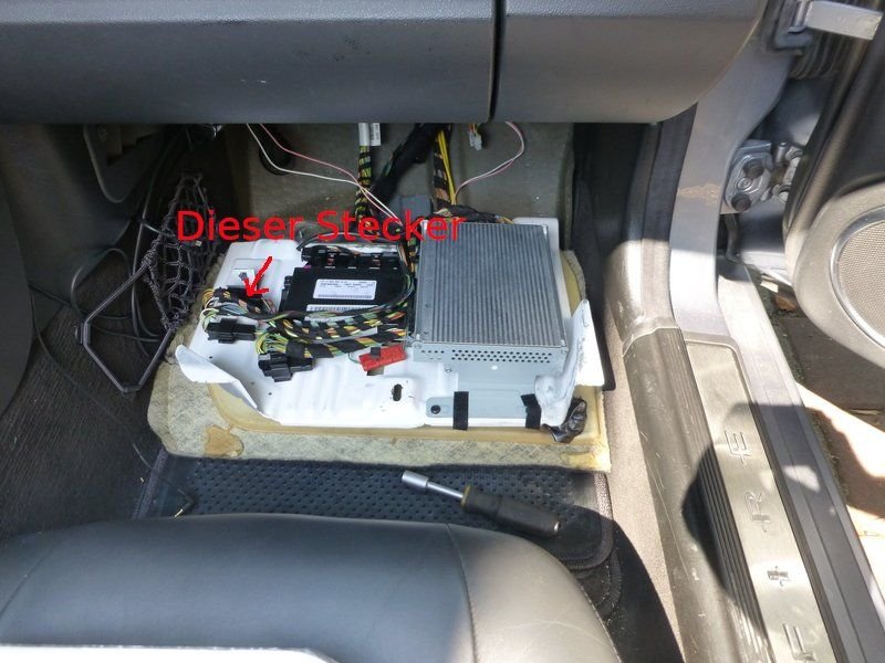

Thanks for the great offer. I'm happy to accept it, there is a cable that goes from the skreem to the bcm through which serial data is transferred.
The BCM is responsible for controlling the central locking pump in the trunk via CAN (unfortunately not the same CAN as the skreem to the PCM).
There is a connector in the passenger footwell behind the cover where the amplifier or the transmission control unit is located where this serial cable can be easily tapped.
This plug is also a potential source of error if the Crossfire can't be opened with the remote control (I already had a Crossfire with this problem).
You wouldn't even need to decode these signals, just record them (1x for open and 1x for close) and you can try reproduce them with an Arduino.
I would have no idea how to do that with the Arduino. But it works, the SPI and I2C protocol shows what the Arduino can do that.
In the picture the arrow points to the connector, is a connector with if I remember correctly only one cable.
So we are in it! Thank you.
I'll try it out this weekend and share the results.

By the way, what do you mean with source of error?, I'm asking because of my remote got broken and I use the key to open and close the car, would it be a problem with the tests?
In this Crossfire the connection in the plug was bad, we cut the plug out and soldered the wires together and the issue was solved.
But this has nothing to do with a broken remote. In your case... if you can record the signal who goes from the skreem to the bcm and can reproduce this with a arduino, you have solved your problem too
EDIT: I see I haven't understand your question right. If your Crossfire opens all doors and the trunk when you open and close it with the key this should work too. What also works is the switch in the middle console with the key on it.

Unfortunately I don't have the right EEPROM and because of its age it is very difficult to get it. I have ordered some in China and it will take 4-6 weeks until they are here and until then I can only continue testing with a similar EEPROM.
Second, today I was able to prove that the Immobilizer off hack generally works.
But I still have to do some hardware and software development.
Take care of you and stay healthy.

I have not attempted to do what you have, but have relevant experience with vehicle CAN bus hacking. I have built a CAN emulator/translator for one of my other Chryslers, to allow a late model SATNav radio to work in a non-CANBus vehicle. I used a Teensy 3.2 (Arduino from PJRC), which has an on board CAN protocol bus. Also, I use your identical OLED. It is indeed dimable, with the right code. Will be glad to help.
Old Apr 22, 2020 | 02:52 AM
  #140 (permalink)
Viper-666's Avatar
Joined: Aug 2017
Posts: 210
Likes: 41
From: Germany
Default Re: I hacked the Skreem, the Skreemulator
I think I don't need the OLED any more, I'm going in an other direction, I will place my module directly in the ECU that will have a lot of advantages. I have to solve a few issues I have by doing this.
I'm still working on it, even if I haven't posted an update for a long time.
But at the moment it takes a bit longer to get the necessary hardware, so I often have to wait for parts and can't make any progress in this time. This slowes my development down...
But if this new way is a dead end and I go back to my first version, what since month and about 300 starts works fine in my Crossfire, I will be happy if you could help me.
