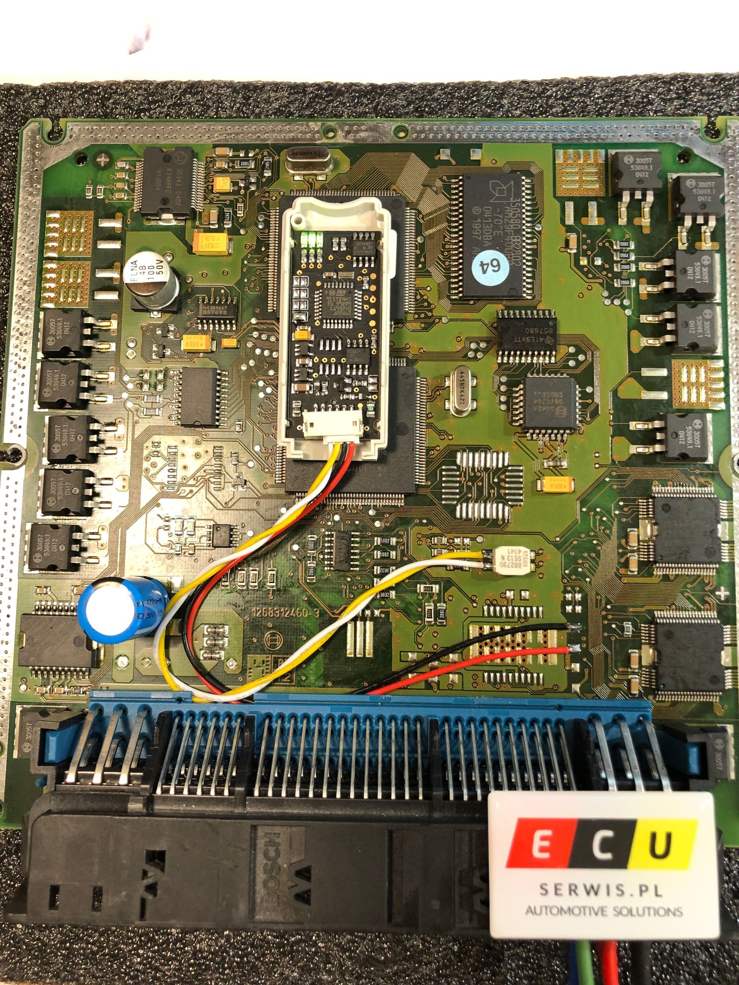

in Europe there exist a real SKREEM emulator for a long time, without any restrictions, it works like the original in terms of unlocking the immobilizer, the SKREEMULATOR pretends to be every of the key implemented in the immo 0 to 7 , with the right numbers of starts as programmed in the MB(Yes MB , it no mistake) factory.
For add EMULATOR don't need change any one byte in PCM : www.instagram.com/p/B_W6MWehLPq/ ... solution it's not plug and play.
B.R. from Poland

My post is not a commercial offer, I am currently using my solution in Europe to run these cars.
Because I found this thread on the forum, I understood that I should show the existing solution.
If any company wants to distribute this device in the US, please contact to PM.
Brief information on how to add My SKREEMULATOR (copyright for this pretty name - of course belongs to Viper-666) :
there are two ways:
One is to read the eeprom from the ECU (95P08) , from this data I will create content for the emulator.
Second way : the data needed to work the emulator can be read by communicating with the ECU via CANBUS , in this case it is not necessary to open the ECU, and as in the first case I create data content for the emulator from the information readed info content,
and as in the first case I create data content for the emulator from the information readed info content .
Using both methods, we do not change anything in the ECU files in and the data in eeprom remain original.
We can use the SKREEM immobilizer with the keys and the emulator- interchangeably an emulator and SKREEM, of course the emulator must be paired with other key numbers (the ECU has 8 keys stored) and cannot be connected simultaneously - we either use one or the other

First of all, congratulations - breaking this security system is not easy ,I know something about it.
Secondly, I have seen this auction a long time ago and it is clearly written: "For this service, you will have to send in the ECM (original or replacement) and SKREEM module"... What if we don't have SKREEM ?
A real emulator doesn't need any data from SKREEM , only ECU is needed , but always any solution is good , if it works well

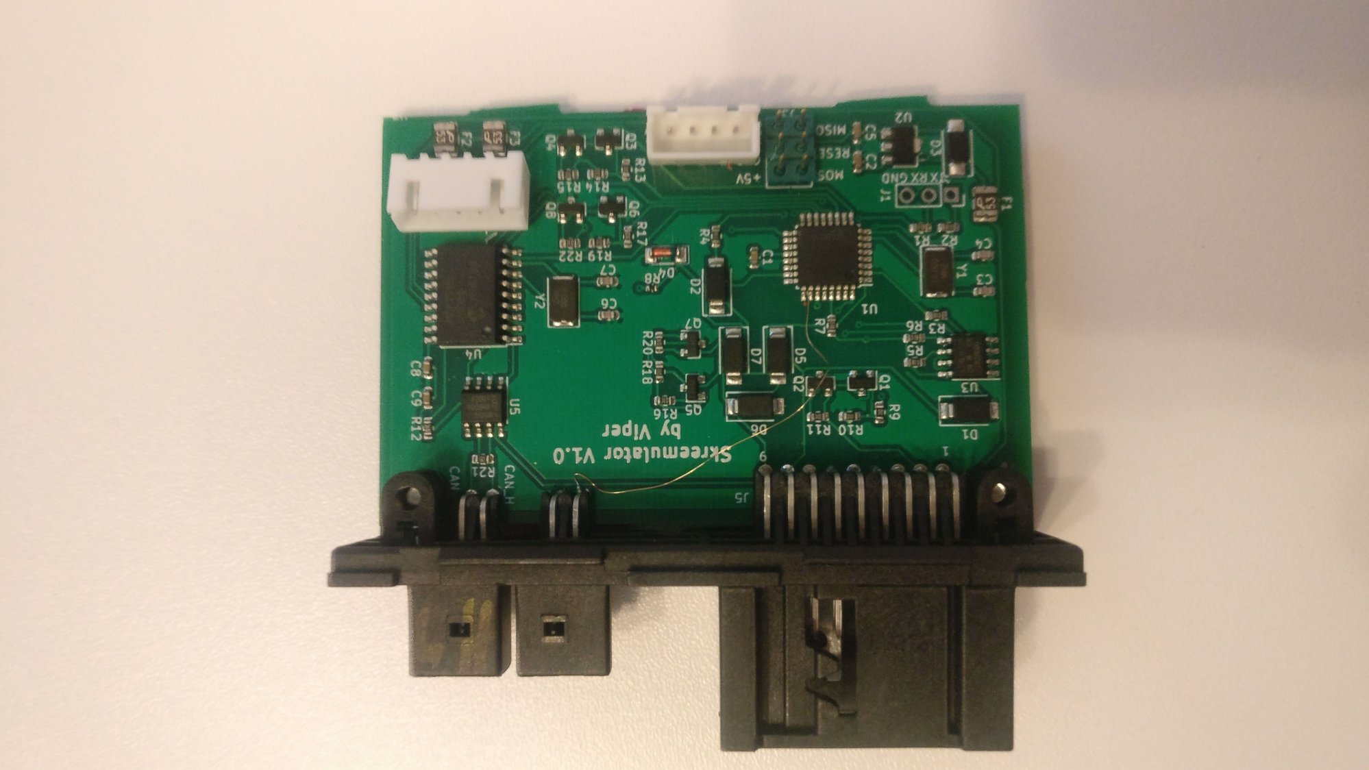

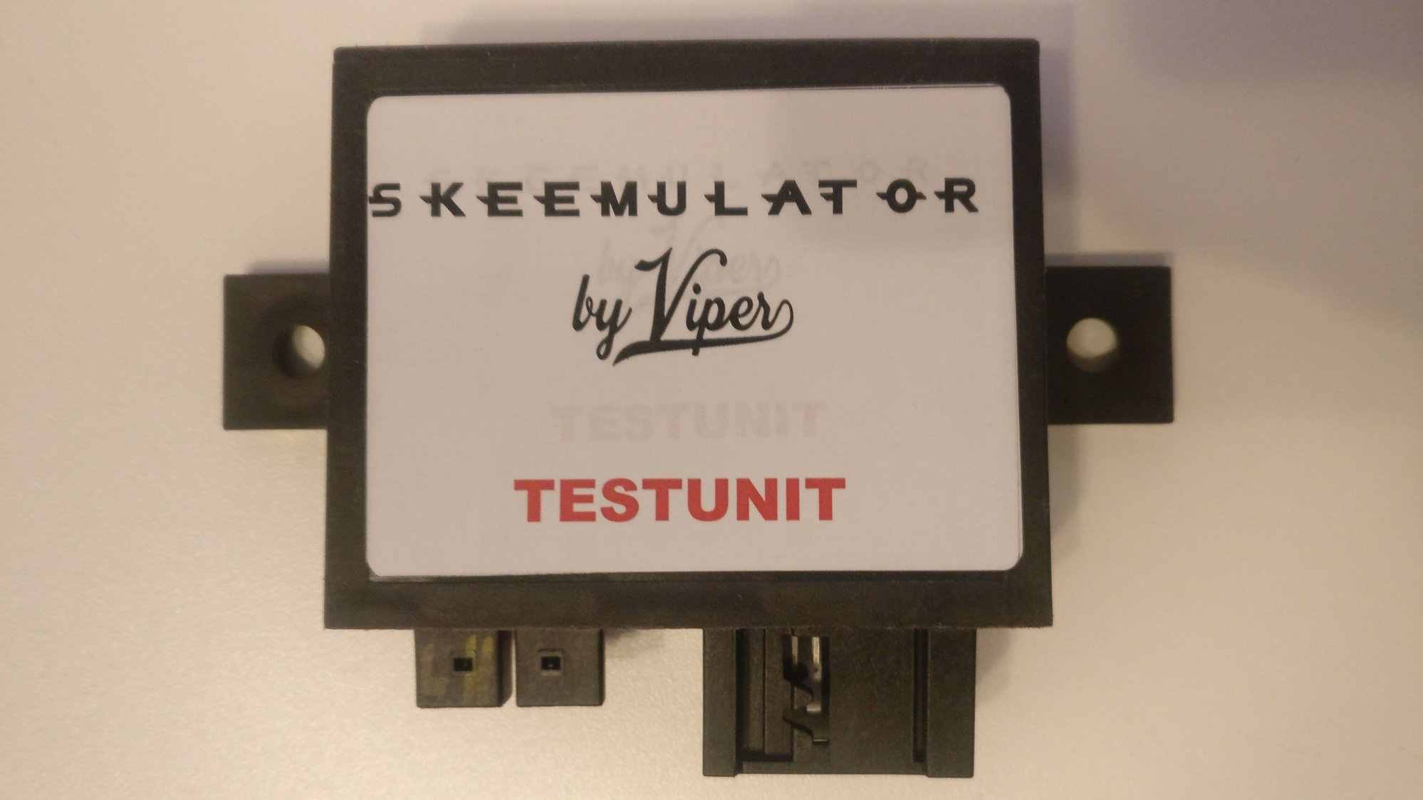

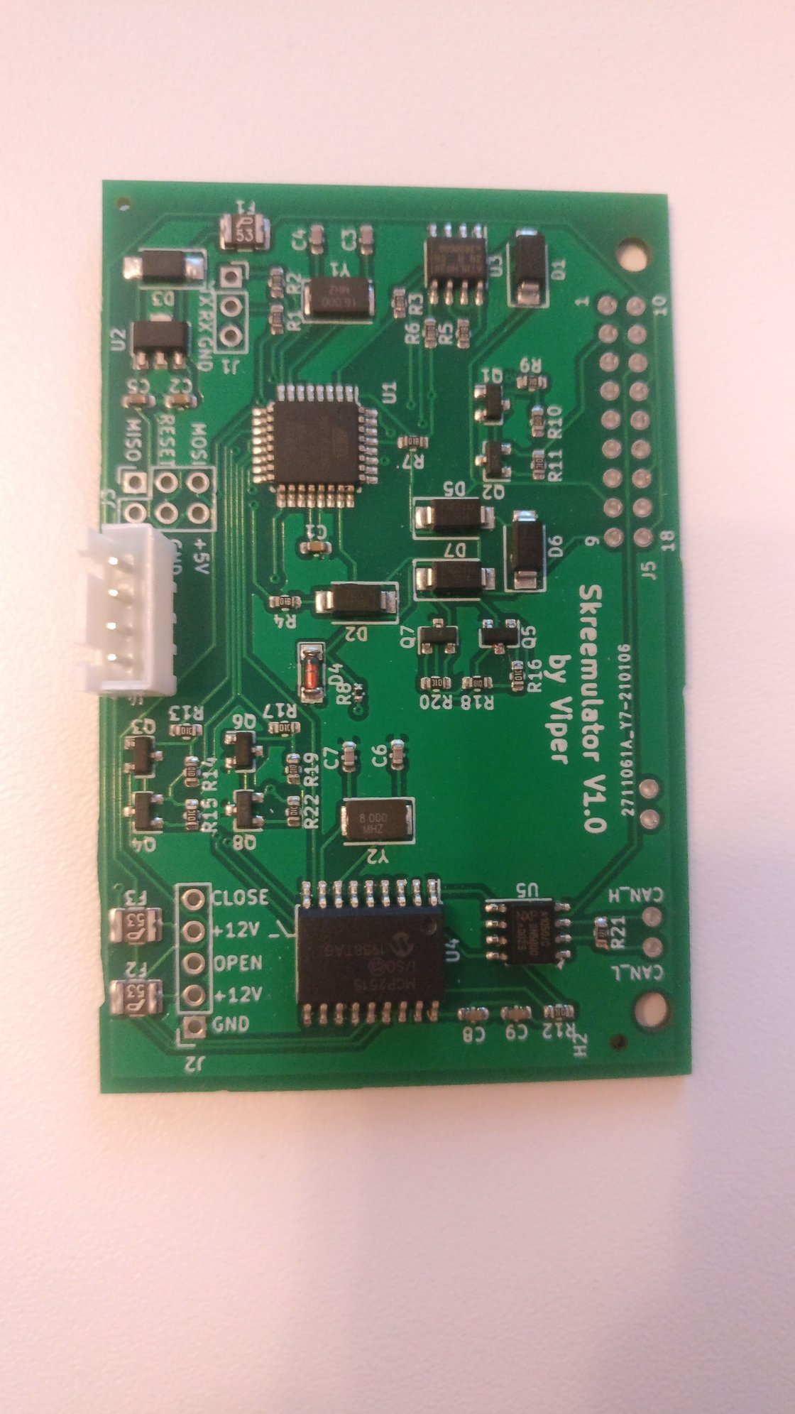

A other Update:
The first prototype PCB of the Skreemulator is ready.
There are still a few small things that need to be changed but generally everything works as it should in my test setup.
Next week it will be installed in the Crossfire.
The raw PCB
PCB with plugs
With housing

The first test of the second prototype (on PCB not on perfboard) in my Crossfire.
The installing is realy easy, unplug the Skreem module and plug my Skreemulator on.
Then install the ECU it has to be programmed to work with the Skreemulator.
On the Skreemulator is a aftermarket keyless open system connected so you don't need the Crossfire remote any more.
I will deliver the Skreemulator with a simple keyless open system what is ready to be pluged into the Skreemulator to work.
But technicaly every after market keless open or keless go systems will work.
The US user also been able to just open the door with the key.
