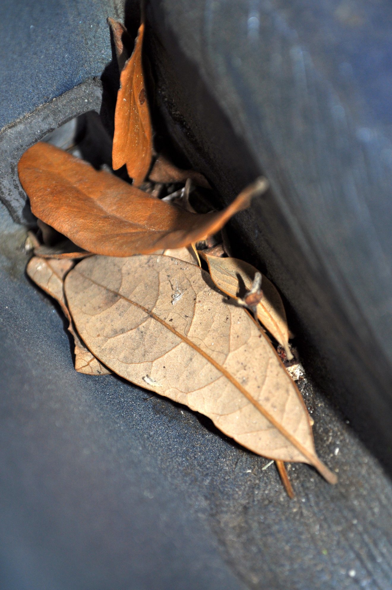

If you pour water down the three centre groups of drainage holes you will find that the water exits two hoses beside one another, one normal looking hose and one with the end pinched together for some reason. With one drain at each end that makes four drains.
The two centre drains exit above the front end of the transmission and can easily be seen.
Leafs at top of photo nearly covering passenger side drain. Just 1" above this drain is the heater/AC air inlet.
Leaves covering drain

Yes, mine were all clogged ! wipers came off with no issues. on the passengers side I found 2 drains, one on the outside close to the fender and another just on the other side of a metal piece. cleaned them all and now need to get it put back together. Someone had used silicone where the cowl meets the windshield trying to fix this issue. So now I know why my fan was fried, where is the amp for the stereo someone mentioned? I have lost the drivers side speaker is why i ask. It is a aftermarket unit (Sony) and I do have power for all 4 channels coming out of the radio going into the factory plug. That is as far as i got with that project.

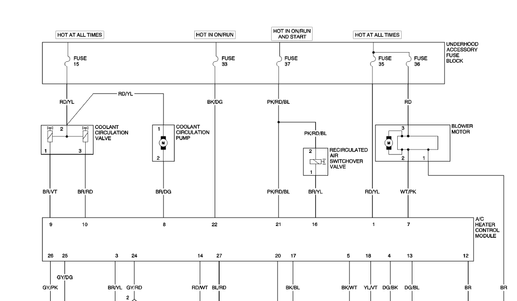

Ok, I need help. New fan and resister but still nothing and its getting late. It does not help that i left my new HF light IN the cowl and buttoned it up! LoL I was able to get it out before turning anything on. I guess its time to find the AC FAN fuse,,,

Default Re: Motorcraft Plugs in my 2005 Crossfire NA !
fuse 36 :

I guess that makes sense . . i was about to give up but I have to see if that works, thanks. I pulled some info off the web and had looked for a fan fuse but must of missed it. I have several interior lights out along with the cig lighter but when I checked the fuses under the hood on the drivers side it was good. Glovebox light, the 2 in the hatch, ( i have a Graphite Limited coupe) seems odd that many lights are out in a car. Right now I simply want to get some AC blowing so I can give my 84 yo mother a ride, she loves the car. Thanks, I will run out and check it soon.
