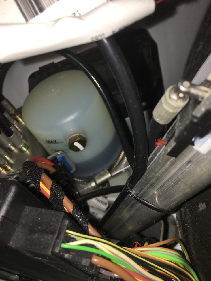

Here are a few photos showing top switch (in rail above passenger's head), trunk divider switch, and fluid reservoir in trunk. These photos are all from the forum.

Am I reading the fluid level correctly, that is is BELOW the 'Min' mark?
Old Jul 22, 2020 | 07:57 PM
Likes: 1,298
Default Re: Top Won't Raise
The level marks are only to be considered accurate in a 'relaxed' state. That is, with the system at rest, not in the middle of a cycle.
So the answer to your question, is a question - Is the system at rest or partway between fully up and fully down?
