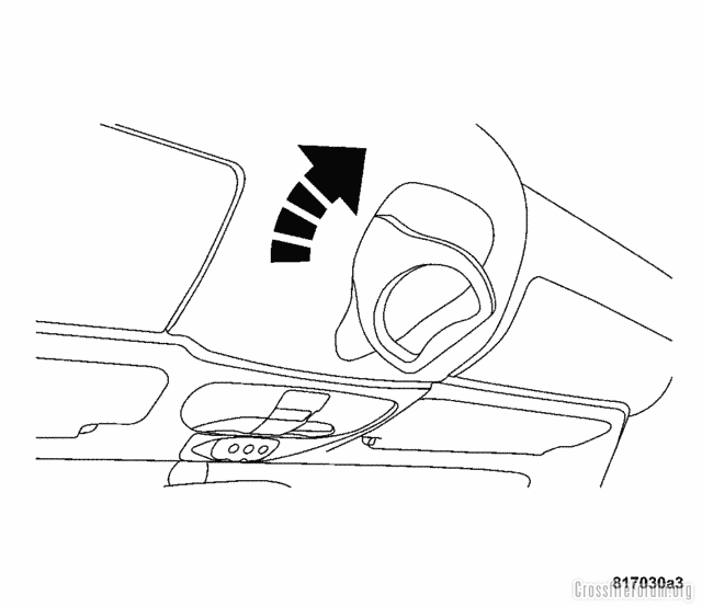

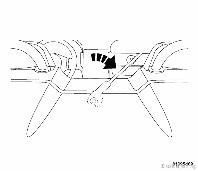

1. Lower the windows and open the doors.
2. Unlock the top from the windshield header by pulling the handle down and turning it clockwise just past a quarter turn.

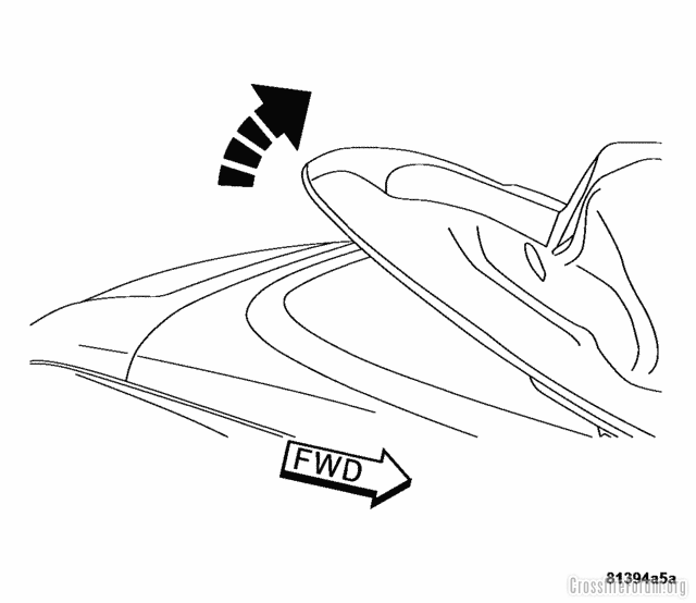

Push up on the convertible top release handle to create a gap between the header and top of approximately 8 inches (200 mm). Once the top is free, rotate the release handle back to its stored position.

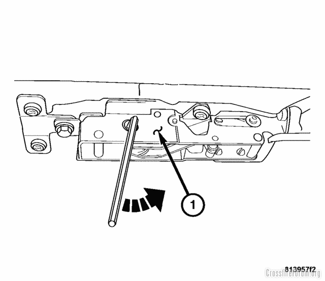

Open the decklid and unlock the rear bow by inserting an allen wrench into the rear bow latch (1) and turning counterclockwise.
· Close the decklid.
· Lift up on the rear bow and secure in the vertical position.

Yea, found that in the manual, but I can't "open the decklid" to insert the tool in that latch-thing under the cover! THAT is where I hit the brick wall.
If I can only figure out how to trick the car into thinking the lid is closed, the top will go down electrically... haven't got that far with the service manual... can't seeem to find the documentation on the wiring from the deck lid sensor/switch - don't know if it goes to the BCM, TopCM or just where it goes. I am NOT afraid to cut/splice wires in order to trick it into thinking the lid is closed!
See, now that I realized my coat is not in there, I am a little pissed that it might not be my fault at all... cept SOMETHING is keeping the lid from closing all the way, and that something is surely the reason the release won't work!!!! I can feel the "spongy resistance" of SOMETHING caught in it when I try to open the decklid.
