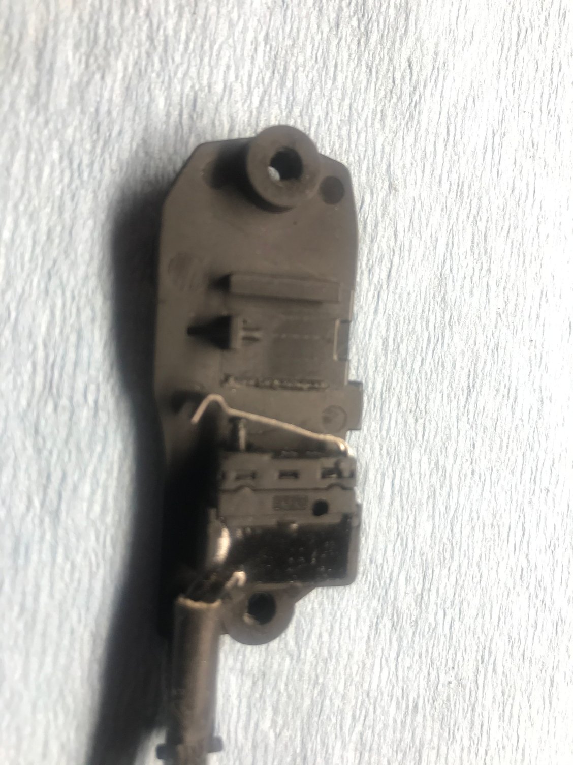

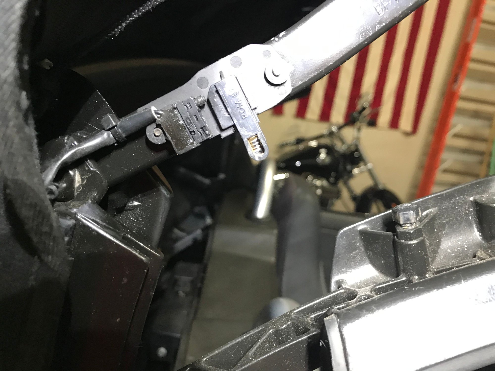

The “roof open switch”, I’m pretty sure the tiny little metal clip that pushes the button to open and close the circuit is missing. Am I correct and this may be the reason my hydraulic pump doesn’t fire up when I push the button. Correct?? Thoughts on how to repair or do I just replace the switch or sensor??
This is a closeup of Pizzaguy’s roof open switch and you can see the small metal spring clip in there much like the divider switch has. Same small metal spring clip
Here’s a better pic of what’s missing on mine. Notice the metal clip

Yep, you need to find another switch or bypass it by putting the two wires together. If you bypass it be sure you don't push the top open button unless the top is unlatched. That is what that sensor does. Sometimes you can find a switch on Ebay.

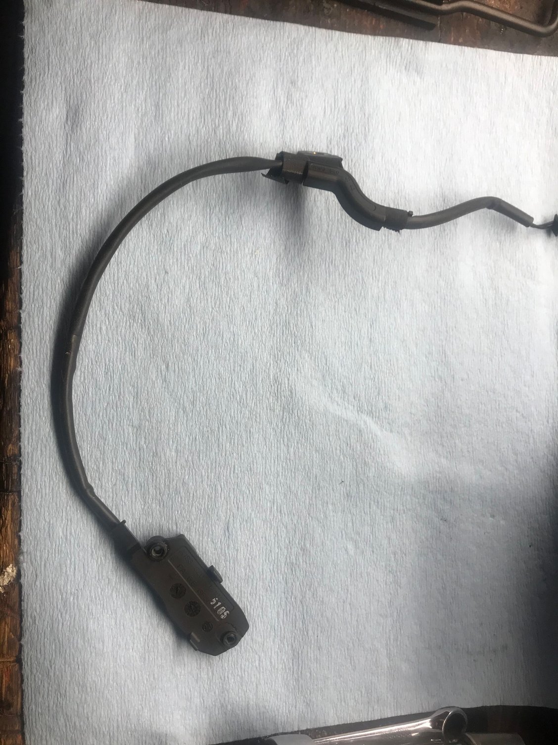

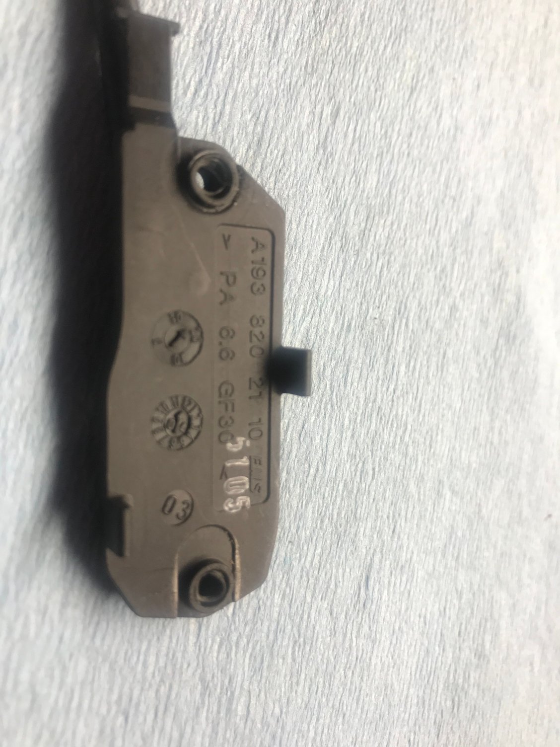

hemi135,
Like you I was in need of this same part. We bought ours at the end of May and I went in with my eyes wideopen as the top, although almost new, would not automatically work. Once this sensor was replaced, then the cylinders all let loose. Top Hydraulics to the rescue. These cars are worth fixing and are a blast to drive.
Researching here I found the part # on this sensor is printed on the back side of it. There are 2 small bolts that hold that sensor to your top frame. The part # you are looking for is: Convertible Top Sensor 1938202110. Do a Google search on that part #. Good luck in your hunt . Check salvage yards as well as Facebook Marketplace for ads on parts cars the owners are parting out.

I just checked my part I replaced and that missing metal tab is intact on my old part. You just may be able to remove that metal tab and install on your existing sensor to make it functional.
here’s pics of my part.
Send me an IM with your address and it’s yours. Let me know.
