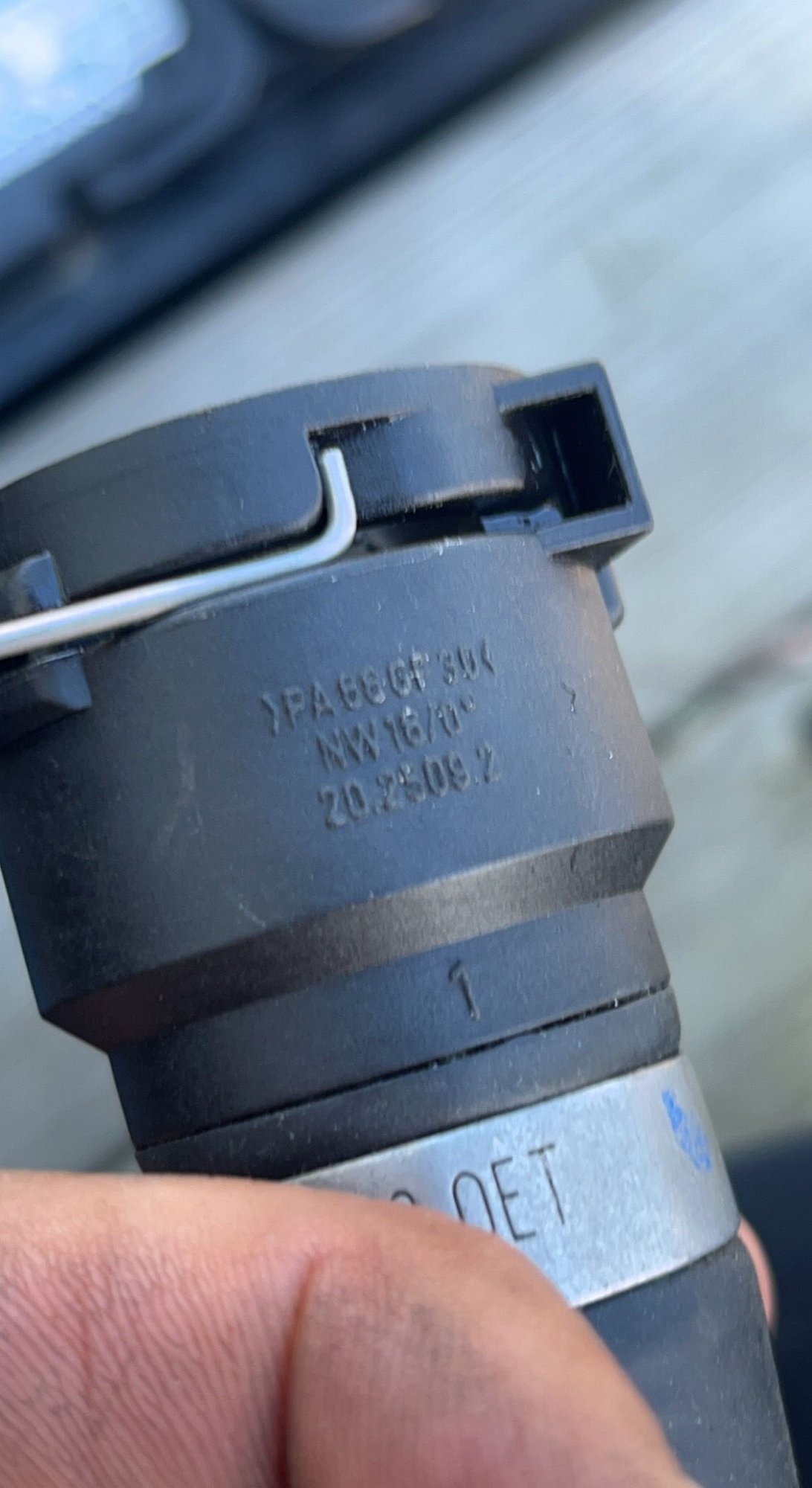

Thanks, downloading it now to look over some things. Also can anyone help with this annoying hose it looks as if it’s been cut and it keeps blowing off no matter how hard I torque down, I have no idea what it’s called but everytime it blows off eventually and I lose all my coolent. Id like to just replace the whole hose.

So I figured out what I needed (still don’t know what it’s called maybe a cooling line coupler?) but if anyone could point me in the right direction maybe eBay or a part number? I need another connector with the metal clip to go on the other side of the butchered hose

Figured it out.. just done away with the little piece the previous owner cut, no idea if it’s supposed to be there or not but I just took the coupling and went straight to the motors nipple.
