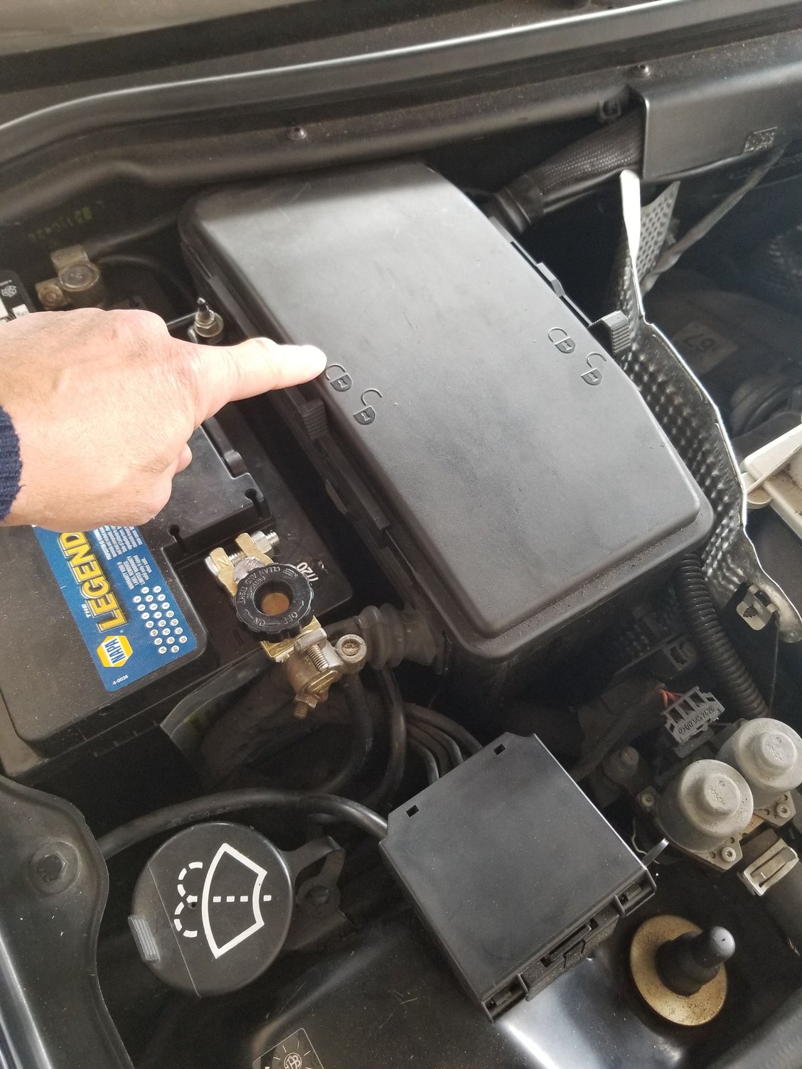

Certainly something to check... To the OP, pull the RCM open it up and check the Fuel Pump relay in the RCM. Could have a poor connection there with signs of burning at the points that may just require a little cleaning with emery cloth. Easy enough to pull and check the contact points in that relay for signs of burning or possible sticky movement. Here's the #4 relay you want to check inside and here's how to get to it... 2005 years Chrysler Crossfire: Locate and removing the RCM module
If you have burning at the points of contact from spark arcing it may result in a closed and open circuit at random that is cutting power and restoring it to the fuel pump at random. You stated, "Limped along for a short bit, then turned the car off and restarted. It ran fine at that point till I got home and parked back in the carport". When you shut down and re-start the relays open and close again so the act of shutting down and restarting may have caused the points to connect enough to run the fuel pump again (for a while) before the problem returns. If I were driving the car and experienced these symptoms and was stuck somewhere limping I'd pull over with the engine still running, open the hood and uncover that box to expose the RCM module and just give it and the box a few bangs with my hand and see if power was restored. A few bangs could also cause the points to resume a closed circuit again. If that worked and full power was restored for a bit I'd conclude my problem was there in that box and most likely that fuel pump relay in the RCM.
Youtube has videos uploaded on how to take the relays apart to expose the points and and put them back together. Pretty easy. Here's one...

Could be the fuel relay in the relay control module is going bad. Open the RCM and look at the relay coils (post a picture?). If the fuel relay coil is way darker than the air pump or horn relay coils, relay may need to be replaced.

thanks for the advice... I will be looking into the RCM as soon as I get a chance. Is it located at the firewall on the left side of the engine......near the battery with the 2 slide locks on it?
Yes

Yes, that's the box that contains the RCM. Watch the video. I see you've installed a rapid disconnect on your battery so pulling and checking the internal relays of the RCM shouldn't be overly spooky. If you are spooked, just buy a spare RCM and try that or keep it in the car as many others do because the stock RCM has a tendency to fail and create the dreaded N0-Start problem due to failed solder joints that can come at any time. Even if you totally screw the internals of your RCM up you can toss in a new replacement and forget about it. Prices of these things tend to bounce all over the place and I see today it is $160 on Amazon that is quite high. I paid about $120 for mine and others have scored some as low as $90. You can search and maybe find a new SMP brand for less than $160 but even at $160 it's still not pricey when you consider what a tow will cost ya, the hassle of being stranded and then probably ending up at some Chrysler dealer that is gonna rape ya with technicians who know nothing about these Mercedes based cars.
