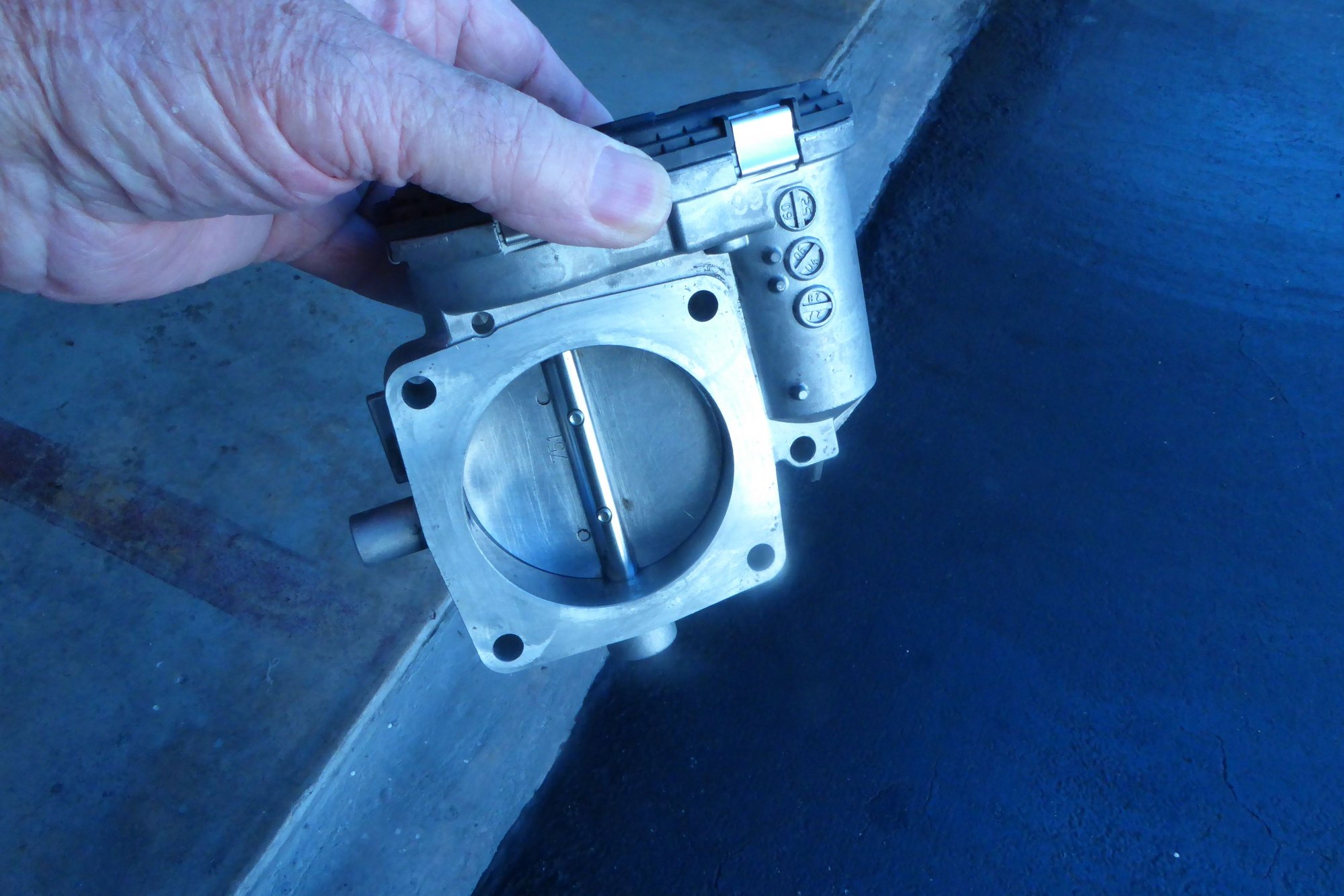

I have a throttle body if u need it, 25 + shipping it is from a 2004 auto.

amx1397 I am interested in the throttle body as well. If anything I like to keep spares of things considering the waning availability of some parts for these cars.
I’ll send a pm.

sent message for TB reset and here are the pic the P/n on this TB is A112441 01 25

I tried the throttle reset with no success. In the meantime I ordered a new accelerator pedal assy. I bought amx1397s throttle body as a fall back.
