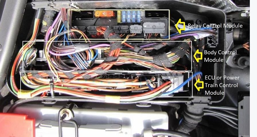

Hello tighed1,do you know where the RCM is on my 2005 XF convertible? thank you

It's in the box next to the battery:
