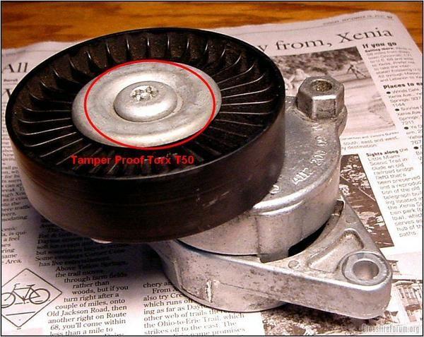

I’m trying to change my drive belt but I’m a rookie and I don’t know what kind of socket I need to loosen this pulley…

No need to use that, there is a 17mm nut a little lower and to the left that you can use the lug nut wrench or a breaker bar with a 17 mm socket. You move it counter clock wise to release the tension.

torx security bolt, you'll need a torx bit with a hole in the middle here's a set but you can buy them individually for the size you need
