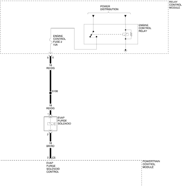

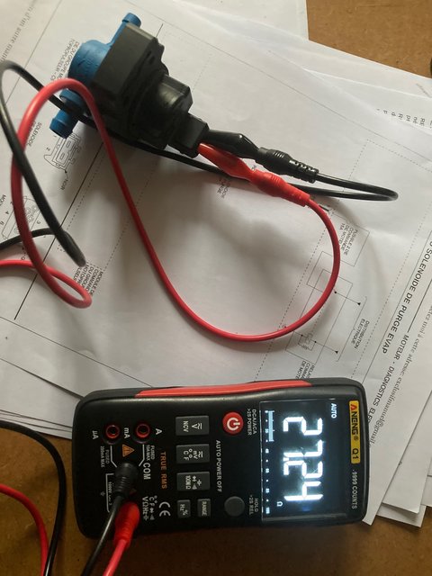

For example, I have 27 ohm inside the evap purge solenoid :
Any solution you test is again ? (please)
In each case, I think there is no so much risk to put an small resistance between (Relay 5-E) and ECU (37-4) :
Thanks again

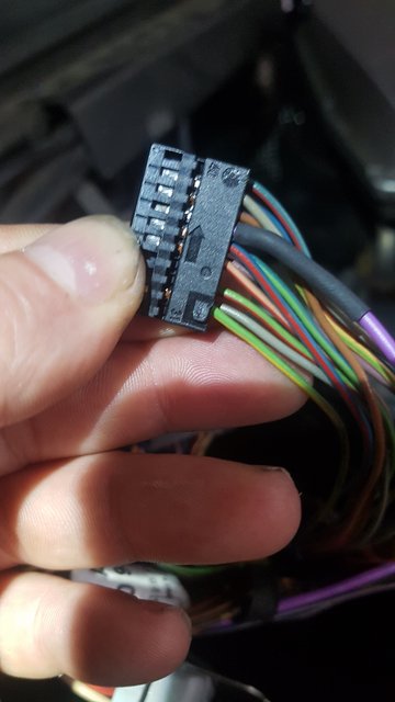

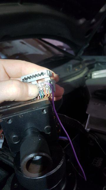

Perform the test with 85 ohm resistance I found
Add a wire in Pin 37 of the ECU on C4 connector
Add a wire on Pin 5 of RCM on E connector :
Resistance between each ...
Not work. The engine start, rotation of the engine go from 1000 rpm to 1500 to 1000 etc... So not the good solution ...
Any idea ?
