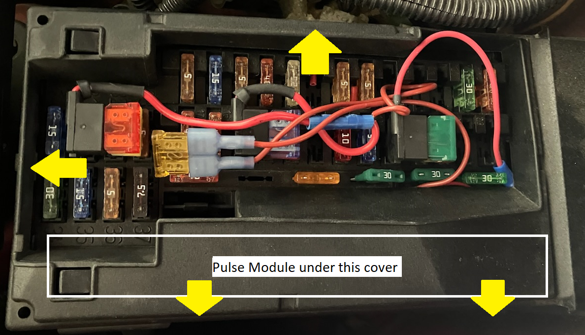

My mechanic can not find the pulse control module for my 06 crossfire… please help

Tell him to remove the fuse box cover, then, at the arrows, bend the tabs slightly and lift off the inner cover:
Then, pry up the fuse carrier using a flat blade at the arrows:
The pulse module lifts out after the fuse carrier is pulled up a little.
