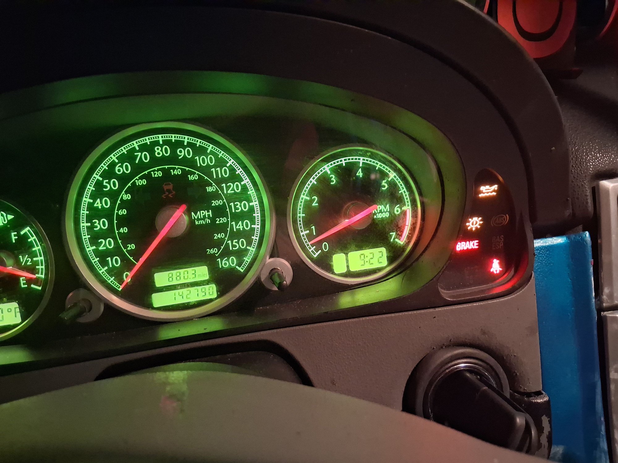

These are the lights that are on all the time when I drive so I don't know how to reset them or get them all off but so yeah the seatbelt thing is always been on even before the alarm started going off somebody mentioned wheel sensor or something like that possibly I'm thinking I need to check that I got sucked into the interior today and my radiator that just blew and my fan that s*** out on me I'm thinking it's because possibly the water pump doesn't work but it's not leaking but I'm not 100%

Top light is the low engine oil level warning. Going down the second light is telling you there is a bad light bulb, usually in the rear tail lights. Third is the low hydraulic brake fluid. Bottom light is for seat belt not buckled for one of the occupants.
This sentence you wrote is very confusing and don't understand what your trying to say, "I'm thinking I need to check that I got sucked into the interior today and my radiator that just blew and my fan that s*** out on me I'm thinking it's because possibly the water pump doesn't work but it's not leaking but I'm not 100%"

That engine oil light also comes on if the oil is overfilled.

I would advise hooking up a scanner to your car and seeing what codes pop up.
Then you have a place to start from.
