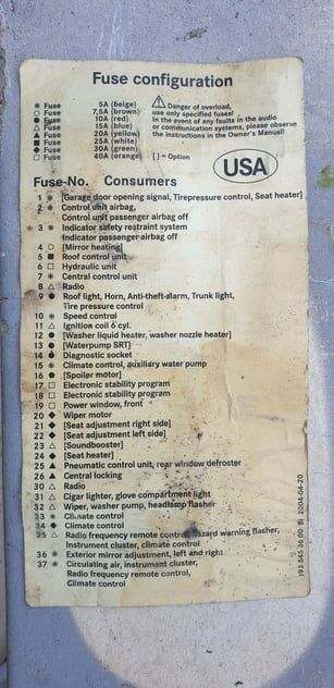

Hi, try replacing fuse number 5 in the engine bay fuse box. That should be the top control fuse.
If that doesn't work out, take a look at this post: Top trouble shooting
