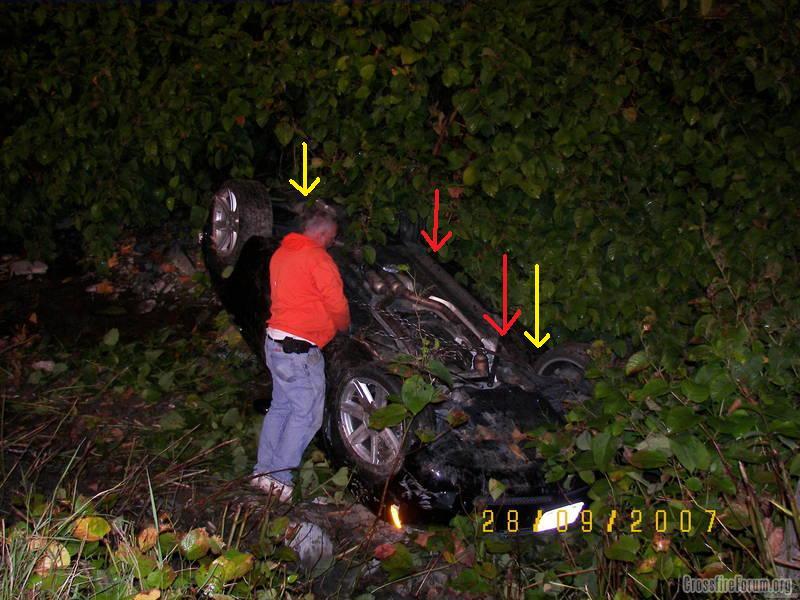

I have my car up on 4 jack stands. I lifted the front by those little black blocks and just the car jack. I put the jack stand on the front braces and its been 5 months and no problems. After I got the front up I use a floor jack and lifted the end up using the rear diff. Then put the two rear jacks on those black block where you would normaly put the jack. Red for jack stands and yellow for the jack.

Thanks for the quick reply. I hope that's not your car!

Ya it was my first crossfire. I slid into a very steep ditch that was about 10 feet deep. Dont worry it wasn't a result of jacking my car up.

My picture is wrong. Sorry but the two front arrows should be switched. I just noticed today when I took my car off the jack stands. 4.5 months its been in the air. What a great day for me.
