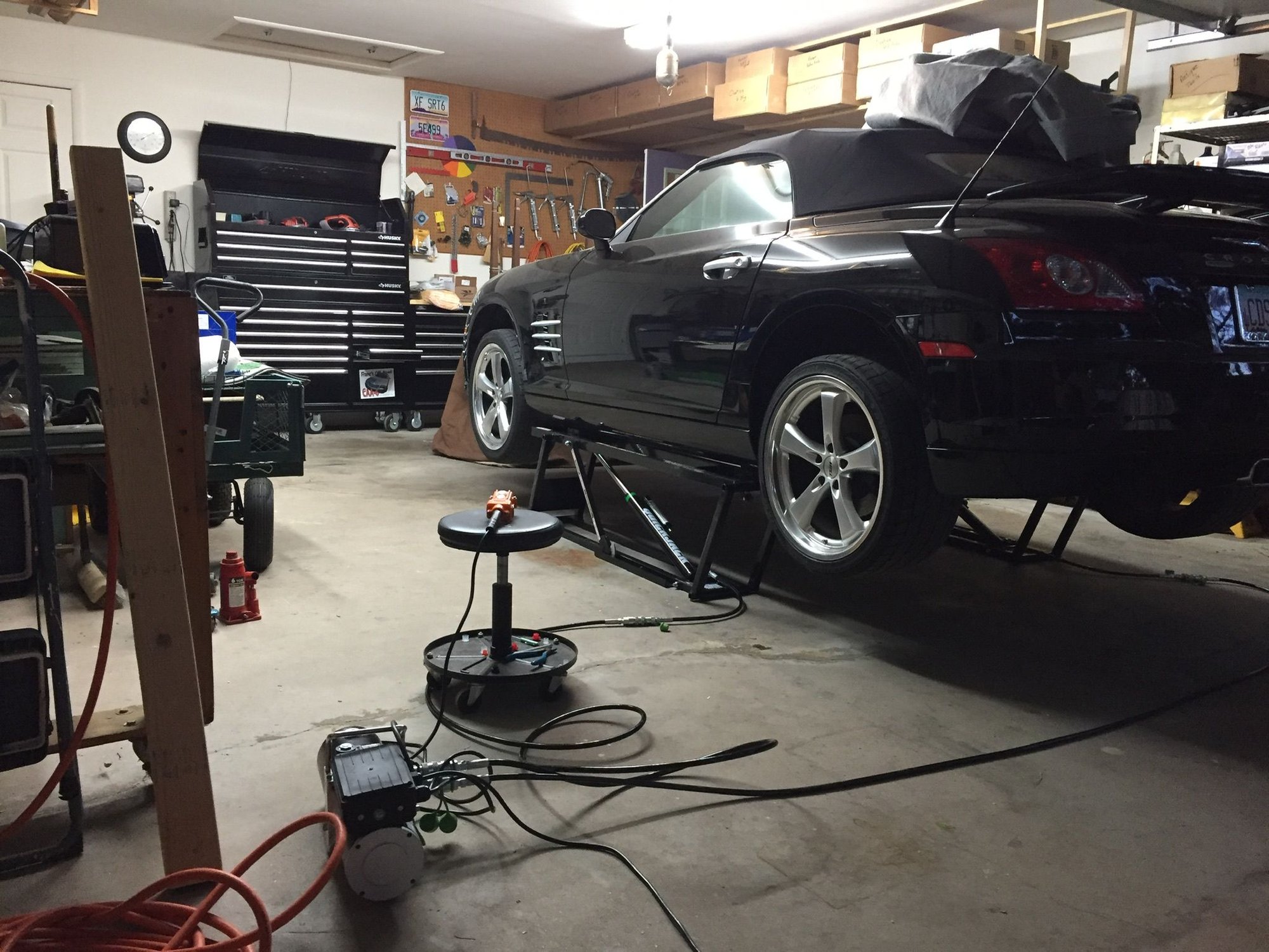

I’m kind of partial to my quick jack.

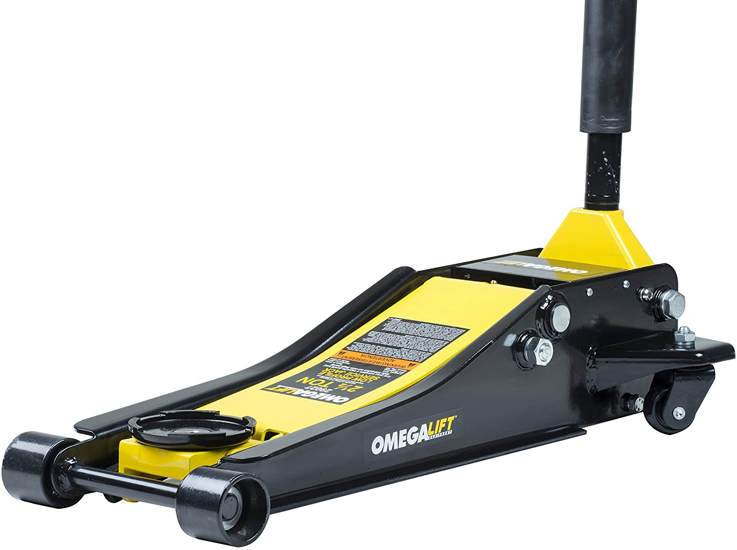

First off, a jack stand does not lift a car, it supports it after a jack lifts it.
Look for jack stands that have a safety locking pin.
Look for a jack with low profile and fast raise.
edit - ( SORRY, I missread your post - ignore what I first said, the pictures are still valid. )
