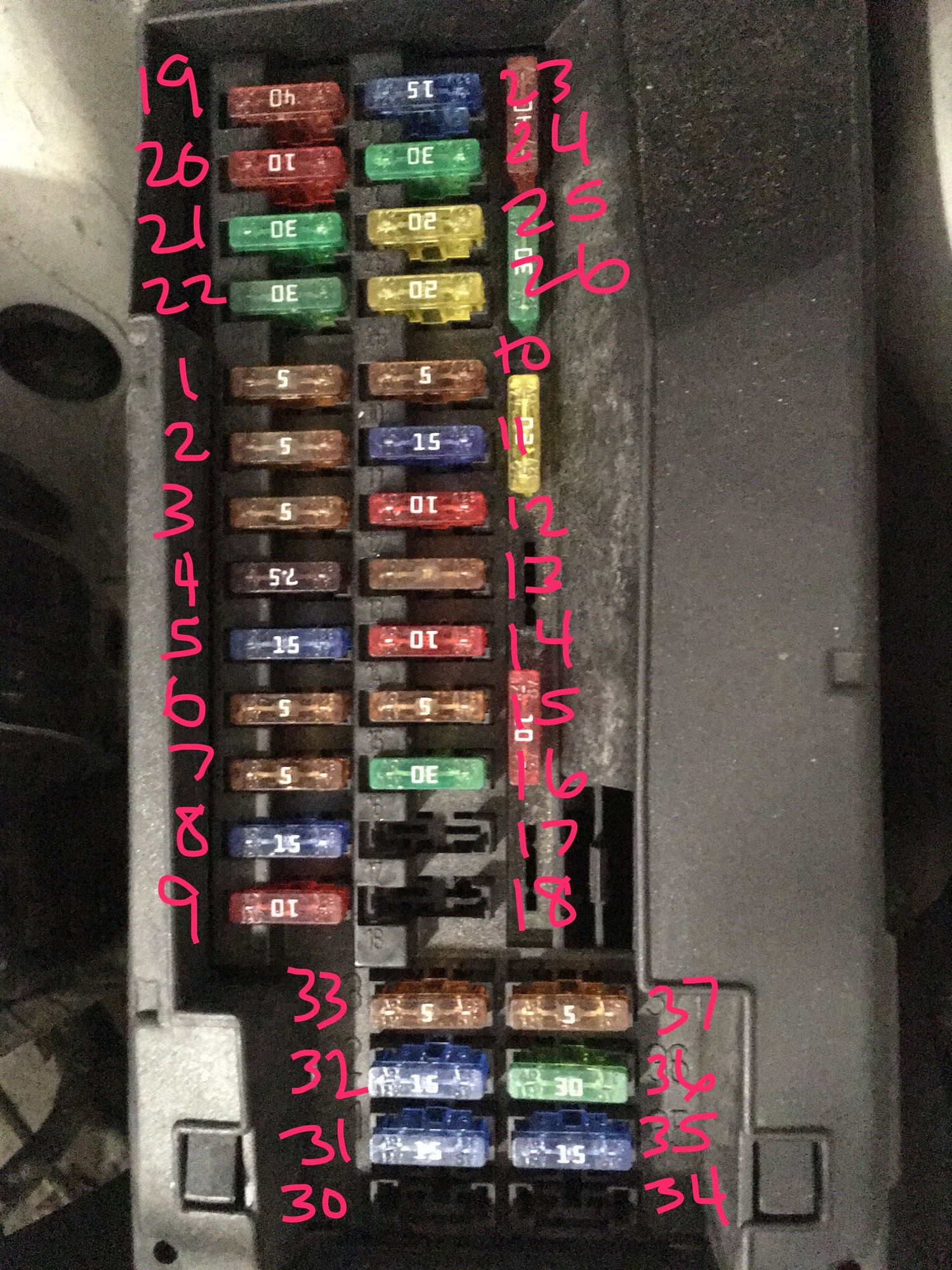

My fuse box underhood

Default Re: How to Repair Relay Control Module (RCM) - (Mystery no Start)
So No 4 & 6 were different sizes than what you showed me. Rather than 30 & 15 they were 7.5 & 5 respectfully. Also where you show 16 as a spare, mine definitely has contacts in the socket with a 30 fuse installed.
Any ideas. Legit reasons it's different or should I just make it match what you sent and try it?
Thanks again.
What I sent is just cut and paste from the 2004 service manual and 2004 owners manual.
I cannot say what is actually correct !

Thanks fire. I noticed though that the schematic you just showed me states a different fuse size in no. 6 than the fuse box diagram you shared earlier. Looks like according to this schematic my fuses were right originally. I am going to reset then to the way they were before proceeding.

Your original fuses were correct, ( see pic )

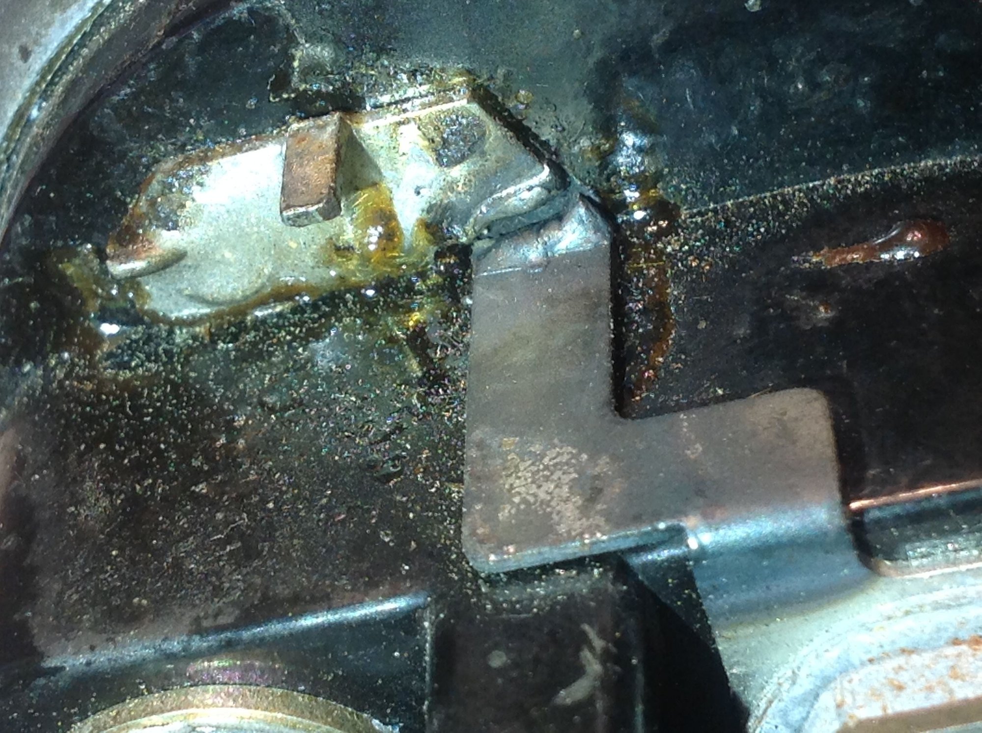

So on the topic of no starting and bad connections. I pulled my starter off while I wait for my RCM to come back. Look at what I found on the starter. I believe it's a ground strap connecting the starter solenoid to the starter motor case.
Old Apr 7, 2017 | 07:58 AM
  #1074 (permalink)
I do believe you are correct, and that does not look too good.
Can you repair it ?

Not sure what kind of repair can be made. I am hoping to take it in and get it tested.

  #1076 (permalink)
Clean up the little bent out tab real good, solder a #6 or 8 wire to it and run to the ground lug with an eyelet. ( Alabama redneck shade tree fix )

It passed twice at the parts store. Unfortunately no load against it but better than I expected. Guess I'm down to the RCM. Ready for it to be running
George has a great answer, that lug looks sturdy enough to solder to. Use a HIGH wattage iron, DO NOT let it melt where the solder is at the plastic base (you can see a wire at the far left of the burned out strap, looks like it is soldered from internal wiring). You do not want a cold solder joint at the fix, nor do you want that (left side) internal wire to get loose if that solder holding it gets liquid, that will probably result in being stranded down the road. IF the fix is 100% reliable, your OK. If it isn't (or you are not comfortable with that large a solder repair job), then replace that starter. I do not know if there is a 'rebuild' kit available, that includes that strap. I am sure there are much lower prices for this starter, than at a Chrysler or MB dealership or parts jobber. Your choice! Good luck with your fix! BTW, I have never seen such a failure, I wonder what caused that kind of fault?
A footnote, looking more closely, you might be able to 'bridge' that gap if it is very well cleaned, and you have a small chunk of copper bar? If so, you can 'heatsink' off that tab that George mentioned which might help keep that left side solder point from 'melting' and pulling that wire out from within the starter. No matter what route you take, if it were mine, I would be 100% sure of the fix (OR) have a boxed starter in the rear if I thought it would fail again (with all the tools needed).
If you have a welder nearby who works on tools you might be able to get it micro or laser welded, these generate much less heat.

BenzFire's Avatar
Joined: Jun 2010
Posts: 33
Dang! Isn't it supposed to look like the pics below?
I'm curious as to what brand that starter is.
