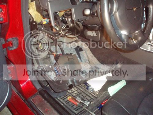

Great diy and with pics too!!! I'm 5'6 and Im going for it too. Just one question, what is the 2nd pic of after you removed the fuse cover and before you unscrew the 3 screws buy the steering colum

its a pic of the underside of the steering column around the lever for the telescoping column, it is showing that there is a small cover that has to be removed to access those three screws in the next pic. it took me a few mins to figure it out too, i actually went out and looked under the dash to figure it out.

Excellent tip on disconnecting the monitoring port connector! After the lower console is off, slide the top of the housing toward the center of the car and the connector pops right out!
FYI -- on the hood release, I had to open (operate) the lever, and turn it 90 degrees to get it to pass up through the console. After removing more screws under there than the 2006 FSM describes.

One thing I wanted to clarify for those who try this in the future: there is a step between pics 9 and 10 I got a little confused on: you need to unscrew (2 screws) the light control/fuse box from the underpanel, as opposed to trying to disconnect the wires from the back of it. Maybe it was just me not understanding, but just in case I'll throw it out there.
