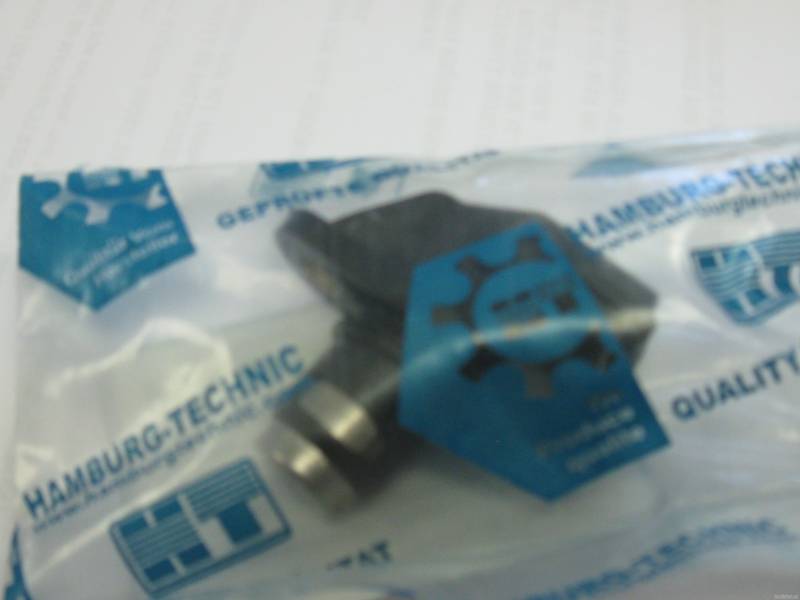

39.00 Ebay Works perfect. made in Germany .

Howard, that is the same exact package mine came in, and won't work, a replacement is on the way.
No where does mine say Germany.

Wow I will go home this afternoon and swap them out and make sure it is the right one , one thing i dont need is a bad part if i need it on the road ,, are they sending you a different part number all together ?

It is the correct part. Just a bad one I guess. Yes they are sending the same part number. James

Go Bosch or go (walk) home.

James I installed the one I have and it works fine no problem car fired right up ,so I guess you got a bad one ,,,,,, but thanks for the heads up ,,,you never know.

Howard, glad to hear that. I will see when mine arrives. Thanks for giving it a try and posting a note.
James
