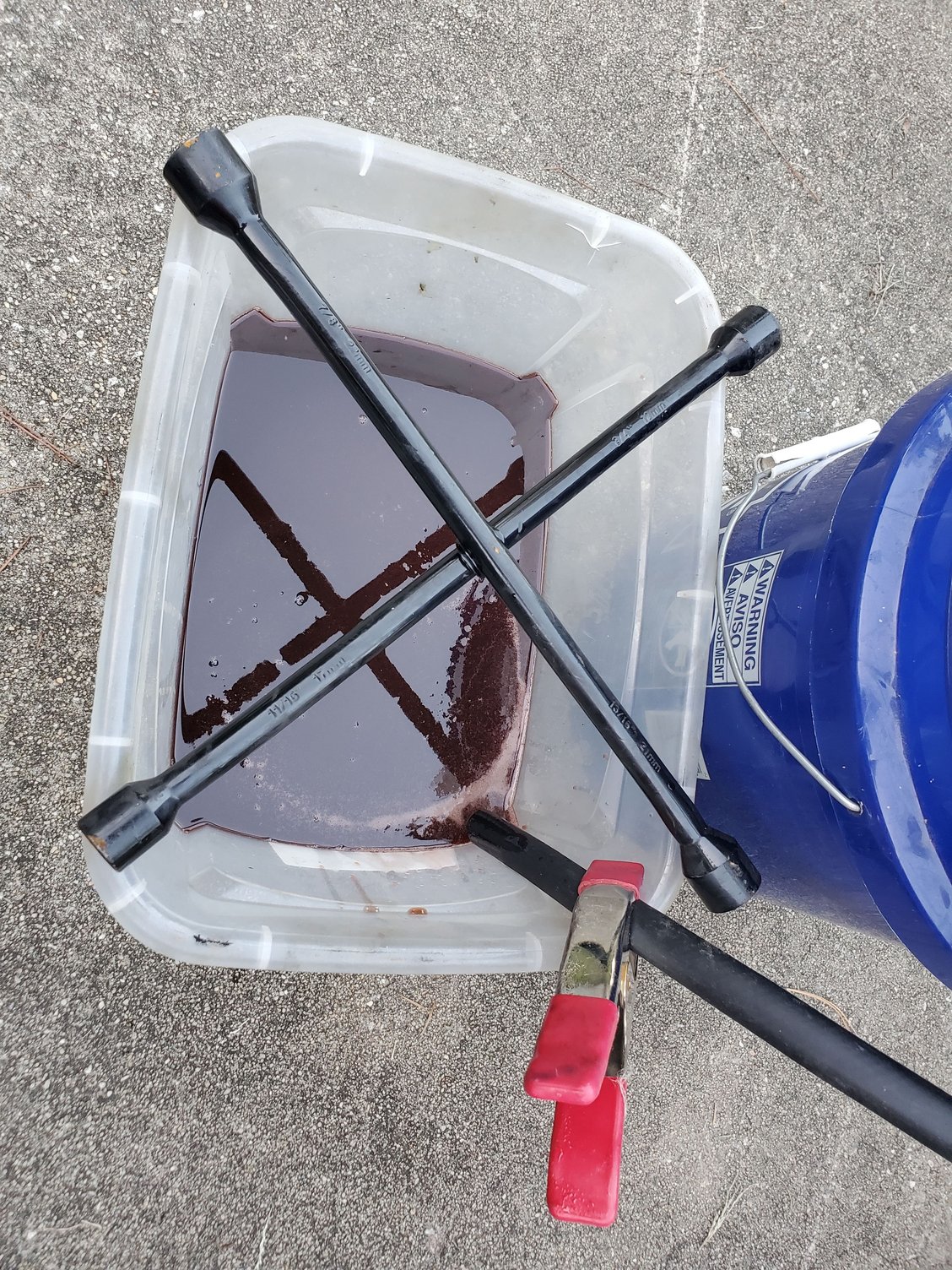

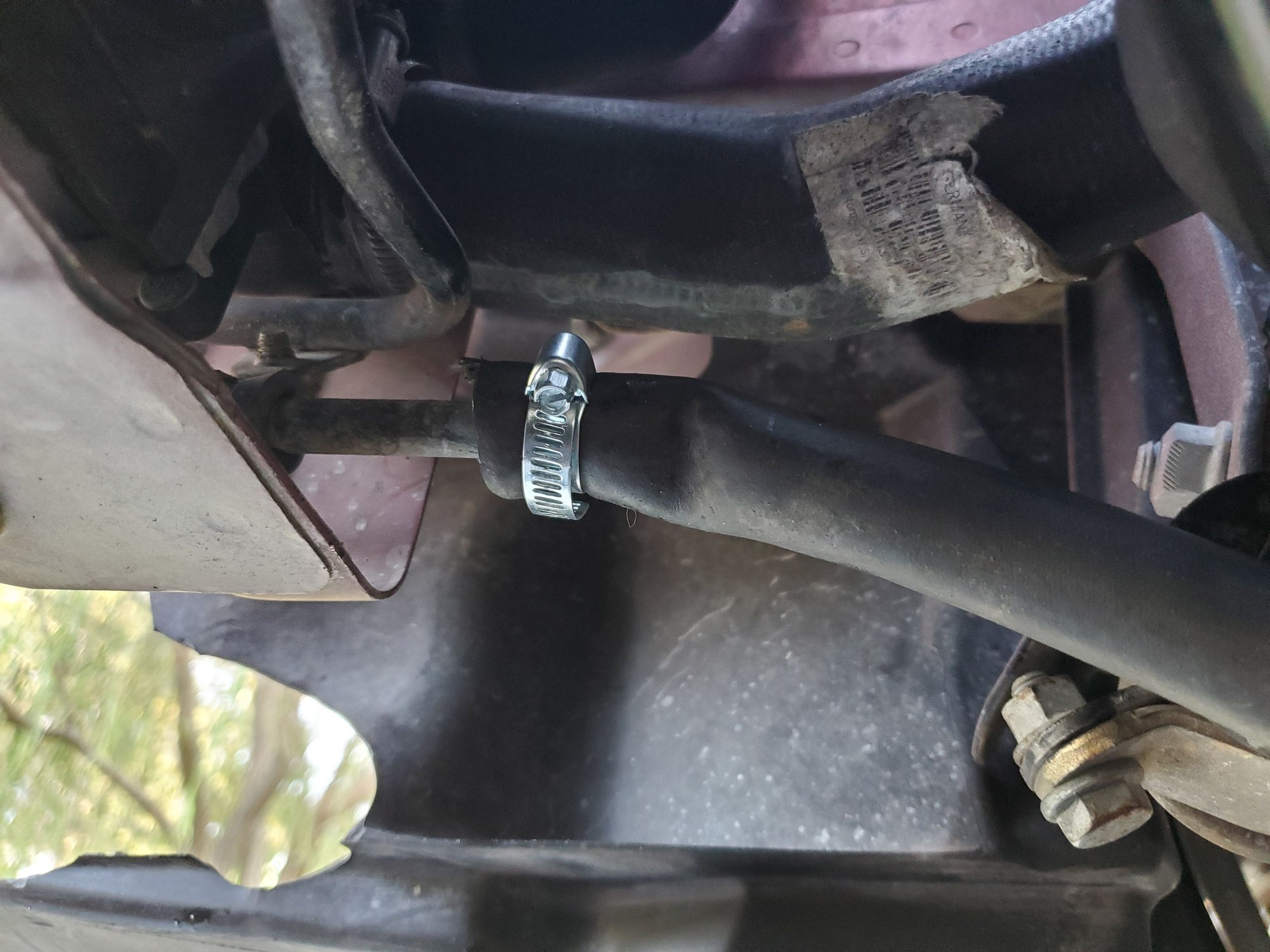

My current status. I got my extra 5 quarts of fluid. I did my flush last night. I used a hose attached to the transmission radiator output and ran that to a container. I had to use a brace and weight to keep the container from flipping because of the hose.
Hose attached to the transmission radiator output
NASTY!
I followed the dump 3 add 3 liters program as listed above. I used a oil pump to transfer the transmission fluid back into the transmission fill tube. I got new tubing to stay clean.
Filling up

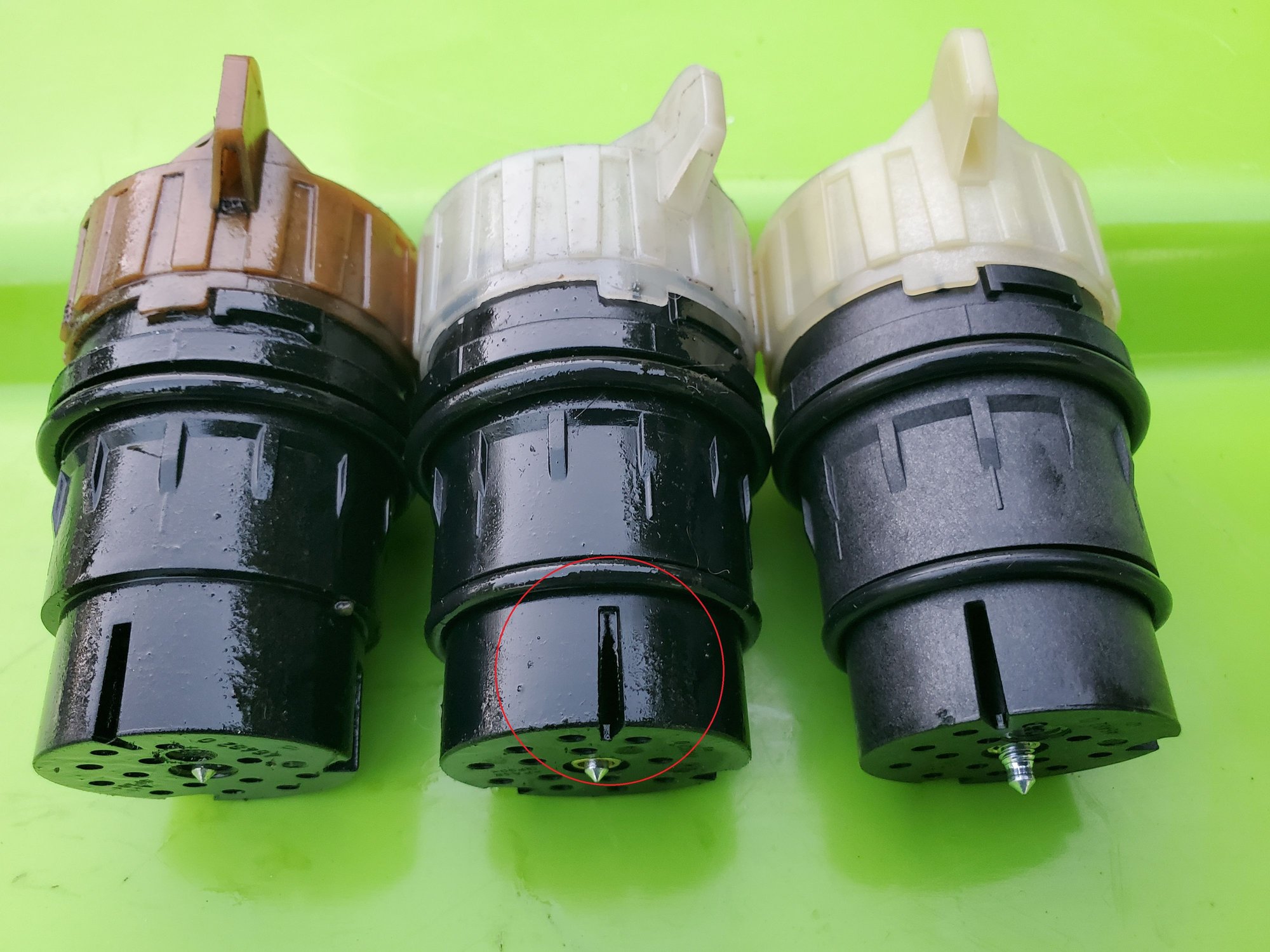

I had trouble getting my replacement bushing to go back into the electrical conductor plate. I found the issue and have a fix.
Old left, bad replacement center, new from FPC on right
Looking at the three electrical connector bushings above, you will see that the slot marked with the red circle is not cleanly molded. Thee is a bit of residue that prevents it going into the electrical conductor plate. The fix is to file away the offending material and it will go back in. Since I have my valve body out, I was able to test this. I will be using the one on the right from FPC. It fits perfectly.

This is always a concern if you try to buy the least expensive replacement parts. I'm not saying that is what you did but a caution to consider when shopping.
Old Sep 21, 2023 | 09:19 AM
  #38 (permalink)
WD40's Avatar
Joined: May 2019
Posts: 756
Likes: 138
From: Alabama
Default Re: Full Auto Transmission Fluid Replacement
Originally Posted by ZERACER
This is always a concern if you try to buy the least expensive replacement parts. I'm not saying that is what you did buy a caution to consider when shopping.
I bought the part directly from Mercedes-Benz and it didn't fit!! (and I'm not the only one)
