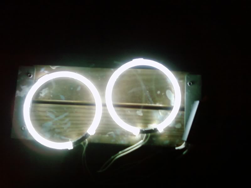

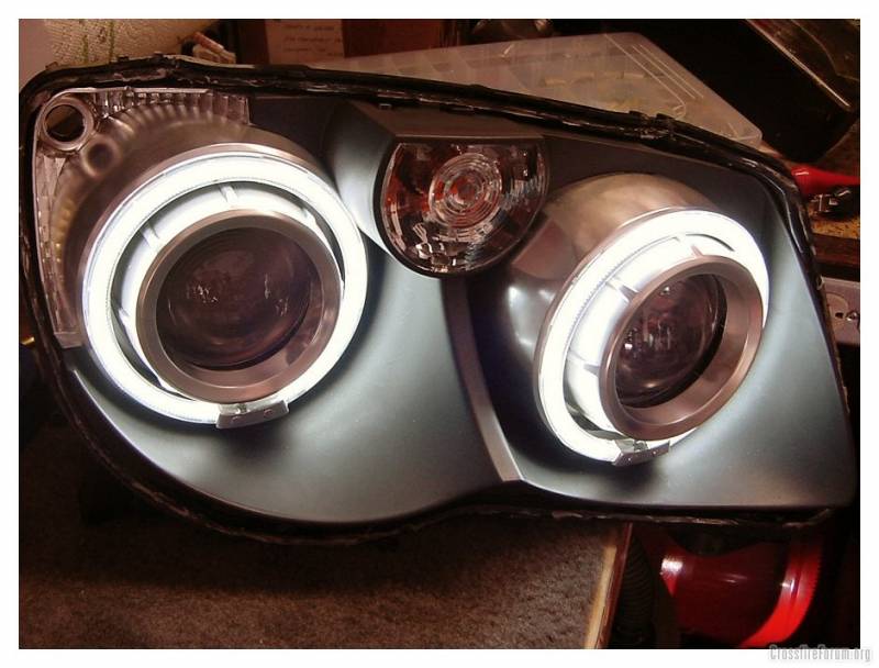

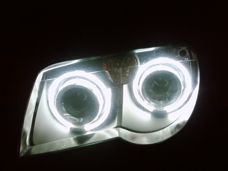

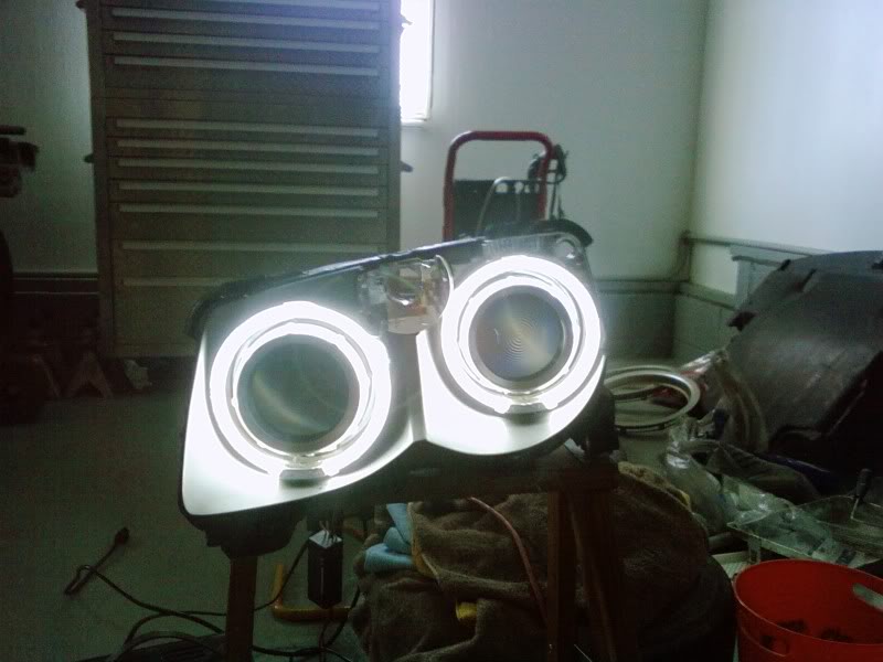

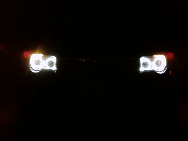

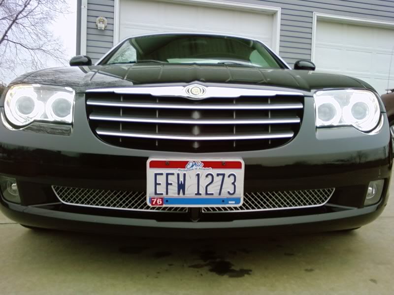

I just finished my own Angel eyes (halo) build in my black 04. i used white 125 mm CCFL rings. this theard was very helpful. thanks to ZeroZero for starting it.

i'll share better pics when i get some.

Good work my man , I was thinking about white rings to start with but the shop was out of stock at the time ,So blue it was . Hope you have sealed the lens fully as i have a very small leak on one side (bummer) , how have you got the rings wired ??? .

Thanks. i used a good amount of silicone to seal them back up, i didnt cut the lens instead i cut the housing enough that i could get a knife under the lens and as gently as i could pry it off. i wired them in with the corner light so they are on if my lights are on. its pretty neat because when the courtsey lights come on after i shut the door the rings light up as i'm walking away. as far as i kno you are the only other person with them in your car, faiz23 showed some headlights with them but not in the car. i'm curious how many people have done this.
thanks again for the info you provided,
Ben

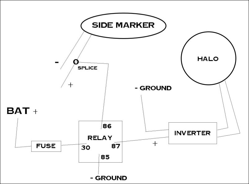

Hi James, I'm gathering info for my AE install. I'm unsure about the wiring, I saw ur post for the wiring, so I was hoping you could advise me on this. Could I run the AE from the corner light or the side -light, if so would I splice into the wiring? If I went with the relay as you showed in your post, where would the relay be inserted? The wiring is my biggest concern because I don't want to fry my electronics any advise you care to offer would be greatly appreciated --Stephen (coolx)

Here is a very crude diagram but you should get the idea.
thank you for the very helpful diagram. I have 4 rings with 4 inverters. I want them on whenever side markers are on like in your diagram, so i need 4 relays???and what amp relays? Would these mount into a relay block??? i wouldn't want to splice into each sidemaker in 2 places and have wires running all over the place. thanks for any help,
Dave
Old Apr 21, 2013 | 09:13 AM
  #54 (permalink)
Posts: 10,460
Likes: 159
Default Re: Angel Eyes Build/Fitting
Dave, My inverters are factory wired to allow for powering 2 rings each. Not sure about yours. One relay per side should due. I don't recall the amp size of the relays. I do recall that the supply wiring to the inverters is really small telling me they can't draw a large amount. A 20/30 relay has worked fine for me over the years. The relay I use has a mounting tab on them. You can mount the relay or if out of sight, wire tye it to the loom. Wiring the supply (+) side of inverters to #87 of the relays should be just fine.
James
James
Ok perfect. My inverters can power 2 rings i just thought maybe id get greater light output, again i know zero about electronics. thanks for the advice. what gauge wire would you recommend?
Dave
Old Apr 21, 2013 | 10:37 PM
  #56 (permalink)
Posts: 10,460
Likes: 159
The light output will be the same whether you use 2 rings or 1, I tried it both ways.
CAUTION: You can NOT change the length of the wires between the inverter and the rings. I learned that the hard way. If you lengthen the wires, the rings will be dimmer depending how much you lengthened them. The manufacturer claims it won't hurt them if you do this if they are too bright for your particular application. However making the wires shorter to brighten the rings may cause premature failure. The length of the supply wires to the inverter does not matter.
14 gauge wire seems to be just fine on my car.
James
