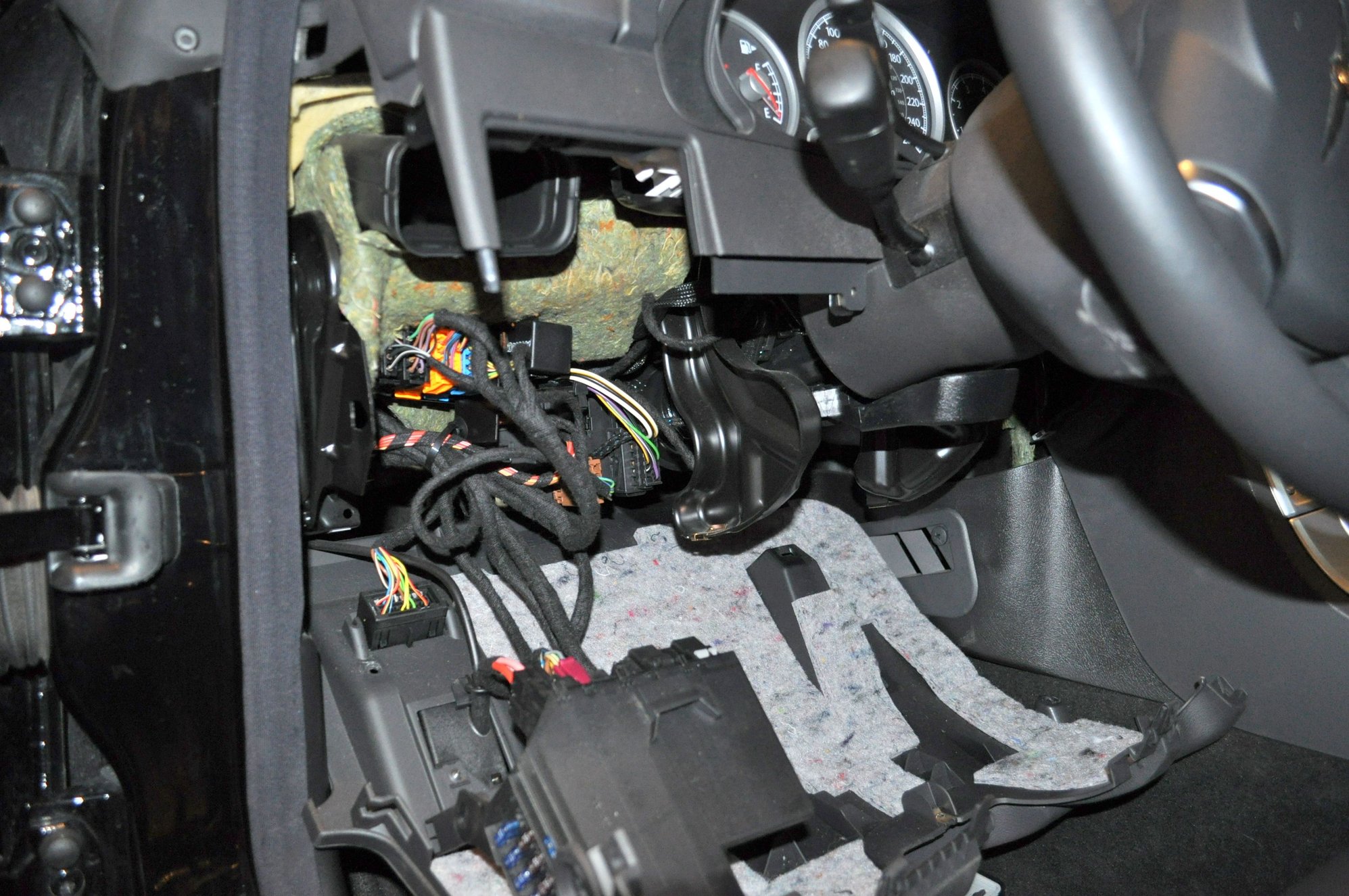

This is under my dash where the relay should be but it's just not......

R/H drive may be different?
