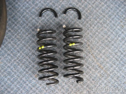

Originally Posted by caddyman3
OK...maybe you will have better luck but here is the deal with cutting springs. From the manufacturer the spring ends (cup seat) are flattened to evenly distribute the spring load into the cup. when you cut a coil off it makes one side of the coil higher (not flat anymore). this puts a lot more pressure on one side of the spring cup. The last one i saw cut wore a hole into the spring cup after a year and a half. it was an easy fix by putting a metal doughnut into the cup but sucked none-the-less. could be wrong though.
Not on the Crossfire...here's a pic - both the top and bottom of the spring are the same
Old May 26, 2008 | 04:57 PM
  #59 (permalink)
caddyman3's Avatar
Posts: 141
Default Re: REVIEW and DIY - Lowered Rear ONLY with Pictures
I saw the pics of the specific springs and looks like it will work, they are not the typical euro spring. thanks a lot to whomever sent the pics!
