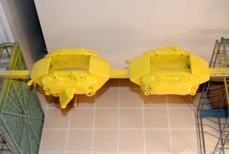

I got my C32 calipers and rotors a few weeks ago and started putting them on this past weekend. Here is the rotor mounted and caliper temporarily in place. Note that there is an extra hole in the rotor. That is the factory C32 bolt hole for holding the rotor on the spindle. I had to drill and countersink a new hole in the SRT location.
The calipers are a direct replacement on the SRT. Take off SRT, install C32. I had the rotors turned to clean them up and bought new DiskItalia TK pads which is what I had on the Aero and so it matchs the rears still. The C32 is a 345mm rotor vs the SRT 330mm. The real reason I changed was to get the 4 pot front calipers vs the SRT 2 pot. I will change the rears to the C32 2 pot later. These are on the Aero and I decided to paint the calipers yellow for a nice contrast (and it goes with the Navy colors).
This is what paint looks like drying..........

I think I just got the final coat of paint on them. I have new AMG decals to put on them and waiting for some new brake pad sensors. Hoping to have them completely installed by this coming weekend.
SilverSaphRT6, I was looking at a set of yellow calipers on MBworld when you were talking about doing yours. I bought a different set of fronts only so I had to paint them.
04Fire, I got the calipers & rotors from a guy on MBworld. $600, delivered. Not a steal, but not bad.
