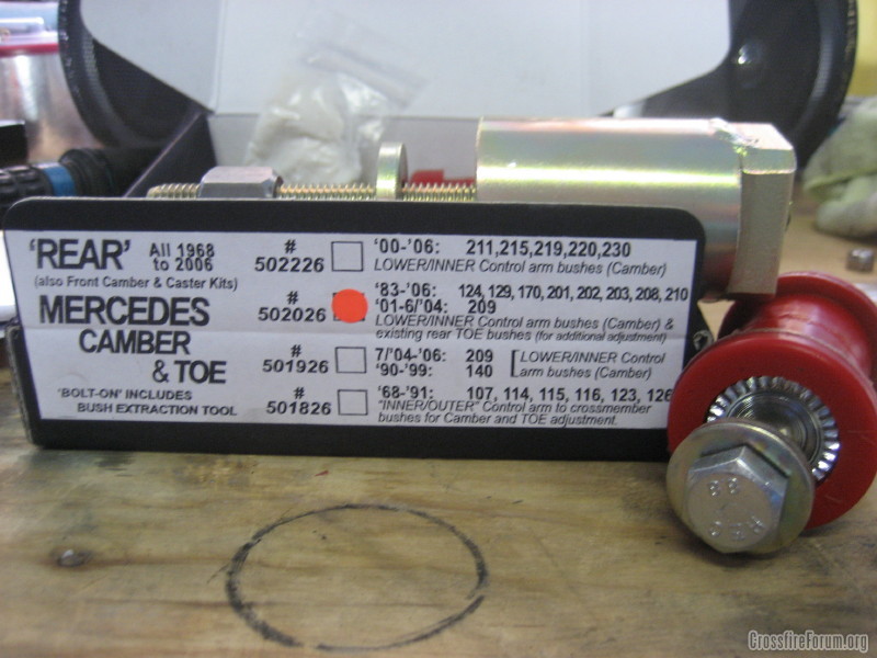

Here is the adjustable K-Mac bushing kit I used - worked well but the big metal bushing removal tool can be a PITA to use - I found lots of heat and torque worked for me.
BTW - I didn't need or install the supplied rear toe bushings.

I've got the bolts up front to get some negative camber but it's not much. Were you able to get a good amount of neg camber using the K-mac's? I'm really needing more neg and searching for possibilities.

Wedge, the kit that Brian shows is for the REAR..... you are correct that the MB bolts in front dont do too much.... they got one side in spec and the other side just at spec on my car....
If you need lots of REAR adjustment.... the adjustable camber arms will do it.....

The K-Mac kit can be bought for the front or rear. The rear kit also comes with adjustable toe. I didn't use the adjustable toe becuase the Crossfire already has this adjustment and I was able to get it in spec. After using the K-Mac kit, I have told others to go with the adjustable links instead. The bushing in the control arm is way to hard to remove. With heat and the supplied tool it would not budge. I used a different method to remove them. The K-Mac kit is great and you get to have polyurethane bushings, if you can get them installed in the lower arms.
