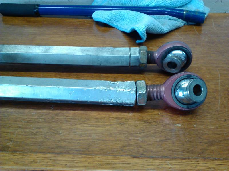

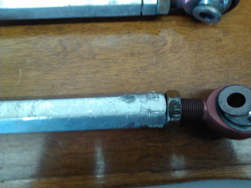

Mike I thought I would share the Distruction of alum. camber rods .I took these pictures ,I still can't believe I was able to repair enough to get home....zoom zoom

Howard,
you were lucky on two accounts, you were able to get it back together to get home and you had the tools on hand to do it..... the new arms will take care of that problem....make sure the jam nuts are tight....
I would say you did more than get home, you drove fantastically with no hesitation, even after the quick fix, you got some ***** on you, Howard LOL
