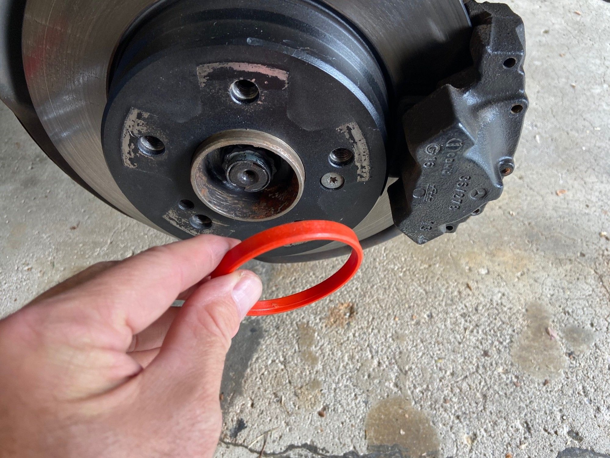

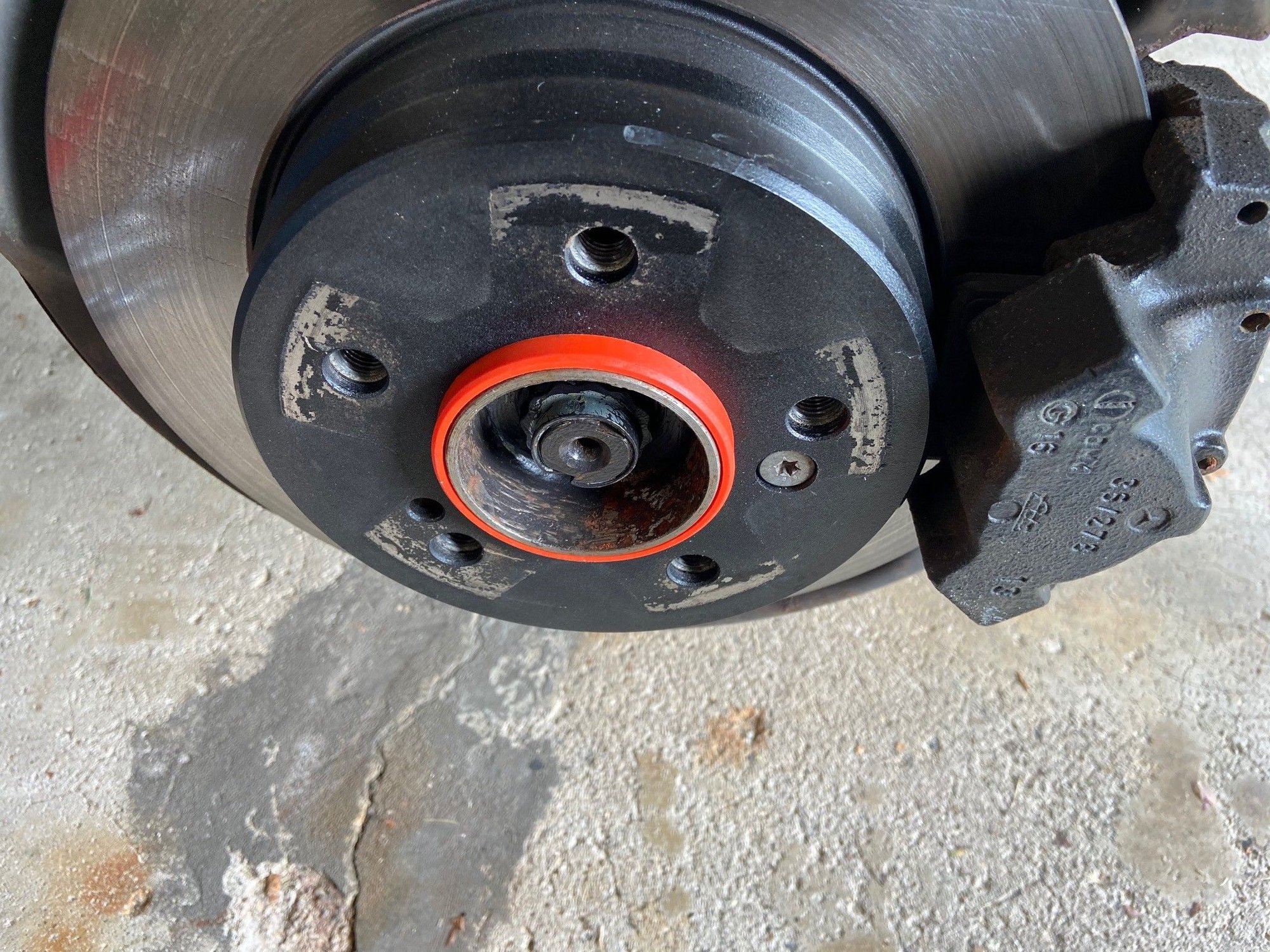

While I agree with Valk's feedback above, you do have options. Even if you find a set of wheels you like that have a different (larger) hub bore, you can purchase a set of hub-centric rings that will press into a wheel's larger hub bore & convert the wheel to the 66.56 mm hub bore needed for the Crossfire. Tuners do this type of conversion all the time.
Old Aug 10, 2021 | 09:32 AM
Tom3120's Avatar
Joined: Jul 2018
Posts: 393
Likes: 28
From: Lafayette Indiana
Default Re: Chrome wheels
This is correct. those hub rings look like this...
