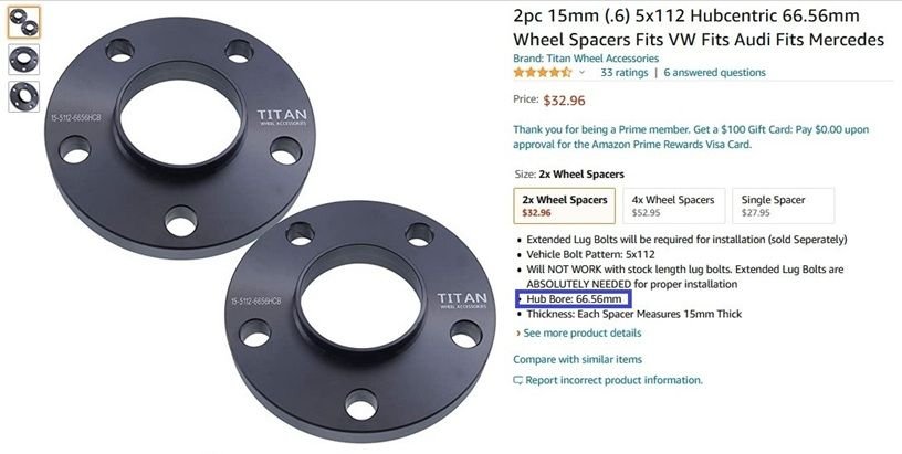

The Crossfire and most Mercedes have a hub bore of 66.56
I have these .........
