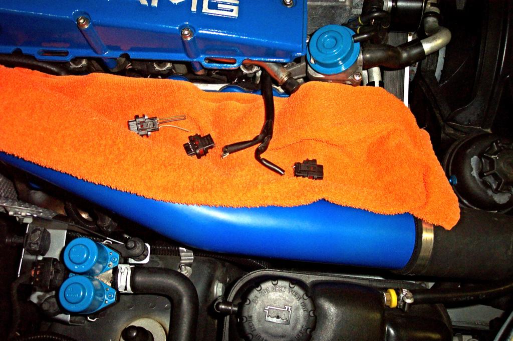

Went out to start the car and take the wife to dinner . . . It started very rough and the check engine light came on. I opened the hood to find the start of a mouse nest and the wiring that connects to the engine coils on the right side of the engine was chewed through! Does anyone happen to have that connector harness?

I'd say it's time to get the wire, solder and shrink wrap out Bob.

I just found you all the repair pieces and emailed you a quote.

Hi Rob (Needswings) . . . Thanks for your usual quick response. As we subsequently discussed, I'm not just looking for those coil connector fittings, I was hoping to find the engine wiring harness. Further research proves you were correct and that engine wiring harness is all one piece. Amazingly, there are two current listings on E-Bay . . .

realize that you must lift the supercharger assembly off the car in order to swap harnesses. easier to just do the repair in my opinion. if you are nervous about soldering, tow the car to a local audio installation shop as they should have plenty of experience redoing wires.

Splice and solder. If you have a need to verify the intercooler all you have to do is pull one manifold and look for a stream of goo. Mine was leaking for unknown years and the car ran fine. A little water and antifreeze is harder on the mind than the engine. I got over some of the mental resistance to splicing with the Zietronix. Cutting wires in the ECU will get your freak on.

Hi Les, Thanks for your input. I bought the complete engine wiring harness for $150.00 delivered to my door. I'm going to put it on the self for now and I'm going to rebuild that damaged section of the wiring harness going to the three right side engine coils. Then if I ever get my new 62mm supercharger pulley from Khang Vo (latest is that I'll have it before Christmas), I'll install that along with the LateModel21 scatter shield and see if the new pulley slips. If it does slip I'll have to pull the supercharger to replace the electromagnet and I can install the "new" replacement wiring harness at that time. There has to be a certain sequence to these things and then one step at a time . . .
