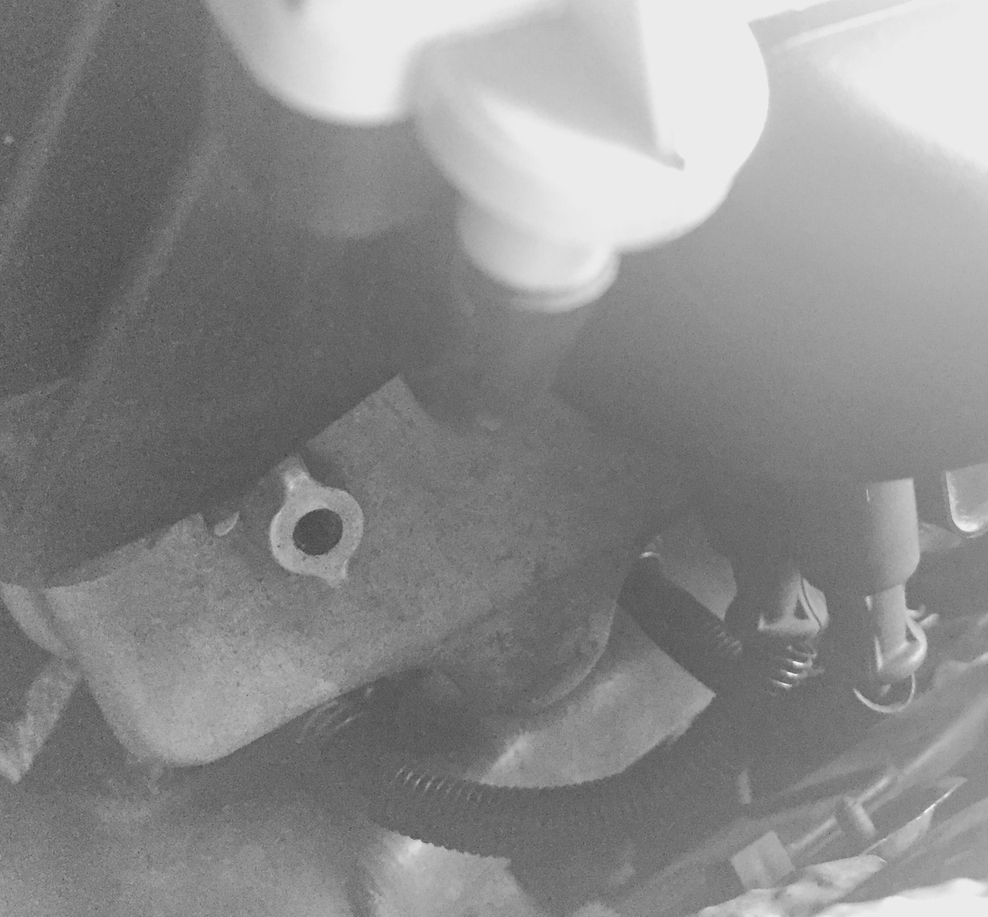

Not exciting but oil free after some fast hot motorways and some time on the twiddaly bit testing the new sticky tyres
Not so easy to photograph

Well, I will give you this. That is a close up....

looking good
1. you can remove the oil fill cap extension neck, use a flat screw driver and pry up on it from the back side and twist off counter clockwise. you can then screw the oil cap directly onto the valve cover and eliminate a potential leak point.
2. I would like to see the hose clamp on the hose connecting the drivers valve cover to the CAI's MAF housing (I sent 2 of them with the kit).
3. you can remove the 4 rubber mushroom grommets on the valve covers as you no longer need them with the CAI
4. your missing the passenger side wiper arm nut cap
5. a little bit of brake cleaner and a plastic brush would go a long way on the top of that intake manifold to bring back its glory.
