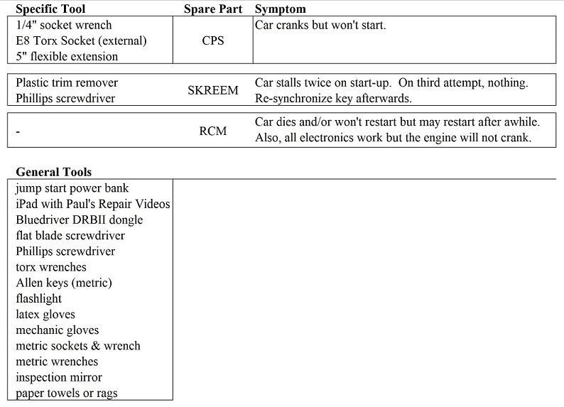

Others have published lists, but here are the tools and spare parts I pack for every road trip. I have taken several multi-thousand mile jaunts in my roadster, and I take all of this stuff. It's probably overkill, but it gives me peace of mind. (Where I travel, I can't count on finding a competent mechanic.) Everything fits below the trunk well panel and underneath the divider, so the trunk itself remains fully available for clothing and gear. Plus, I can still lower the convertible top. Good luck assembling your own kit.

Very good list!

Why bother with a SKREEM? You are not going to be changing that on the soft shoulder.
Crankshaft and cam position sensors as well as an RCM and the tools to replace them are enough.
Along with an AAA/CAA card with a good towing distance on it and a credit card is all you need.
Possibly, but I keep the SKREEM and associated tools in the same kit as everything else. It’s just easier to bring the whole bag.
And being an interior job, I may be inclined to do the swap at the failure location. Just depends...
