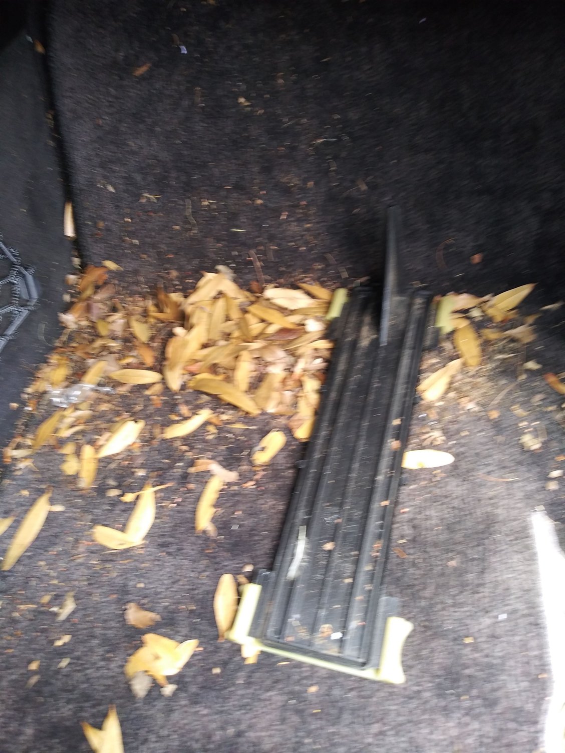

have had the X for a couple of weeks now and started on the general maintence issues. Nothing like purchasing a car from a Florida dealer that is "in perfect condition, 52k miles, needs nothing". So far, one bent rim, major tire balance session, valve cover gaskets, air filters, and an oil & filter change as I have little faith in what was done. Oh yes, the cabin filter (which was engineered by someone who wasn't ever going to chance one).

By the picture you posted, you need to open the cowl under the windshield and clean out all the debris. When the drains get clogged it will allow water inside with resultant damage to electrical equipment.

Welcome to the Crossfire world. You'll love it and you appear to be resourceful. We became owners a year and a half ago. This forum is invaluable. We went thru our car from bumper to bumper, did all of the recommended "fixes" and did all maintenance recommendations and have had nothing but trouble free, top down driving since. Enjoy the trip! This is the forum I spent a lot of time on, over the first six months. How about a pic? By the way, when you remove the cowl to clean out the crap, you may as well fix the windshield wiper escutcheon and replace the siren if it doesn't work .
