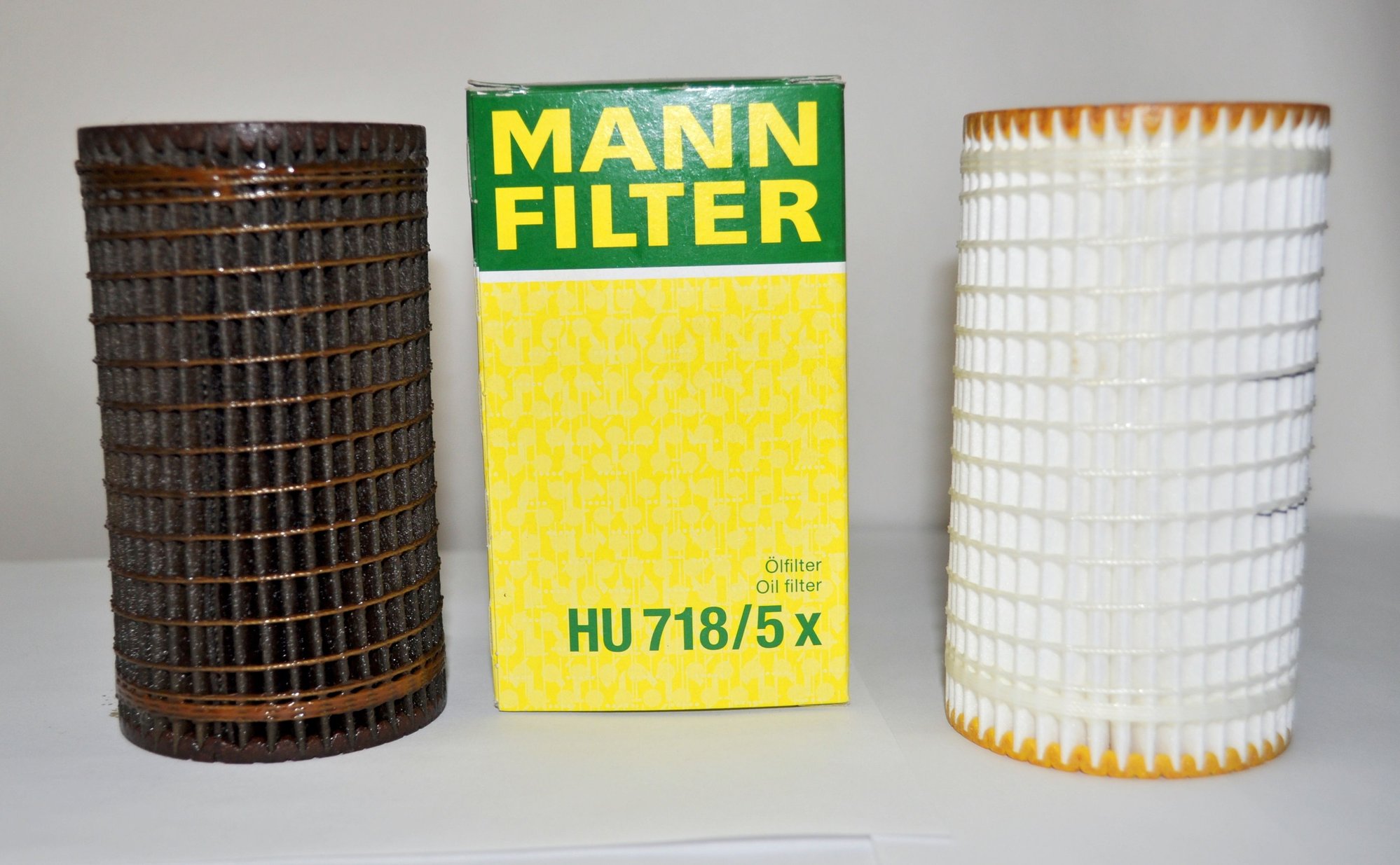

The Mahle is a fleece filter and the Fram is a paper filter, paper filters are a no go in the Crossfire. Use only approved fleece filters, you get what you pay for.
Mann fleece filters, one used 2,500 miles and a new one. The so called fleece is a man made polyester material.
