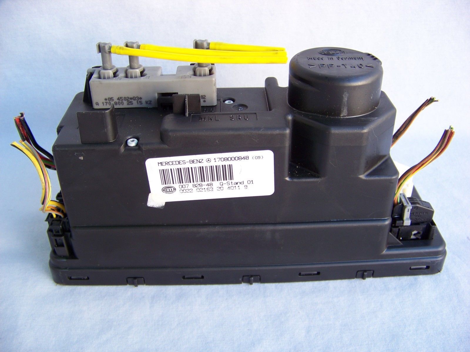

Is it only the SLK-320 pumps that work, or are other 'Benz' models' pumps that are compatible? I'm not sure I've ever seen a list of MB cars/pumps that are 'plug-n-play for the XF.
Old May 27, 2022 | 02:30 PM
Likes: 648
Default Re: Trunk and Console locked and won't open
The sockets on the wiring harness have to plug into the pump in the correct manner or things will be really buggered up. I assume the SLK320 and SLK32 pump will work, also any other pump with the same part number.
Sorry, the links to the Electronic Parts Catalogue are not working, see if this works. CLICK
The part number on the SLK320 and the SLK32 use the same pump, part number A 170 800 08 48.
Anyone buying the pump should make sure that the plugs with pigtails and the Gray manifold come with it as shown below.
Also make sure it has suffered no water damage.
No Mickey Mouse stamp sized pictures for me if I can help it.

I should have been more specific. I meant the Mercedes one with the same number.

During my research, I found MB Part Number 170 800 08 48 and a comment that this part number is the MB equivalent of XF Part Number 5102774AA, the Central Door Locking Vacuum Module. Having faith in the advice of people on this Forum, I ordered one MB part on eBay.
