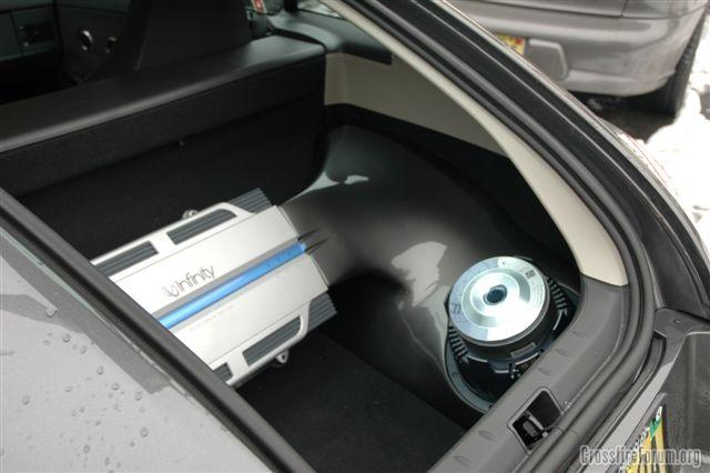

Quick question:
What kind of difference in sound are you going to get if the head/face of your sub is facing in, like Infinity's system?

Originally Posted by smokey847
Quick question:
not much I still have mine facing the rear because that's what I've always done but it really depends on the box, I use a sealed box.

Just to confirm, is this the "facing back" you're talking about?
Clean setup, I like
