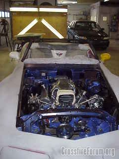

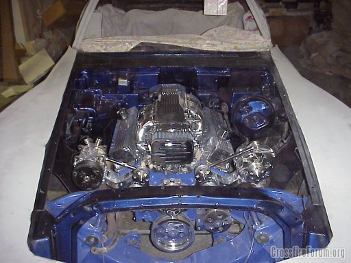

Yeah, I updated it to an LT1 with Tuned Port, I am hoping the engine computer has a VSS wire that I could somehow rig the wing from...

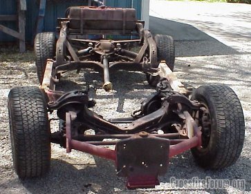

This is actually a car I bought back in 1999, went eyeball deep on a customization project, then my Internet company crashed and burned and it has been mothballed, just finally getting back to work on it. Sad thing is, it has sat so long I will have to basically start over and hope and pray that brand new crate engine isn't seized.
Frame before
Frame After:
At the time I was going to paint it House of Kolor Kameleon (I know, I know, it was all the rage in 1999)..so I had the frame painted this Gawd Awful blue... going to strip it completely down and go with a silver or black probably.
Motor in bay:
