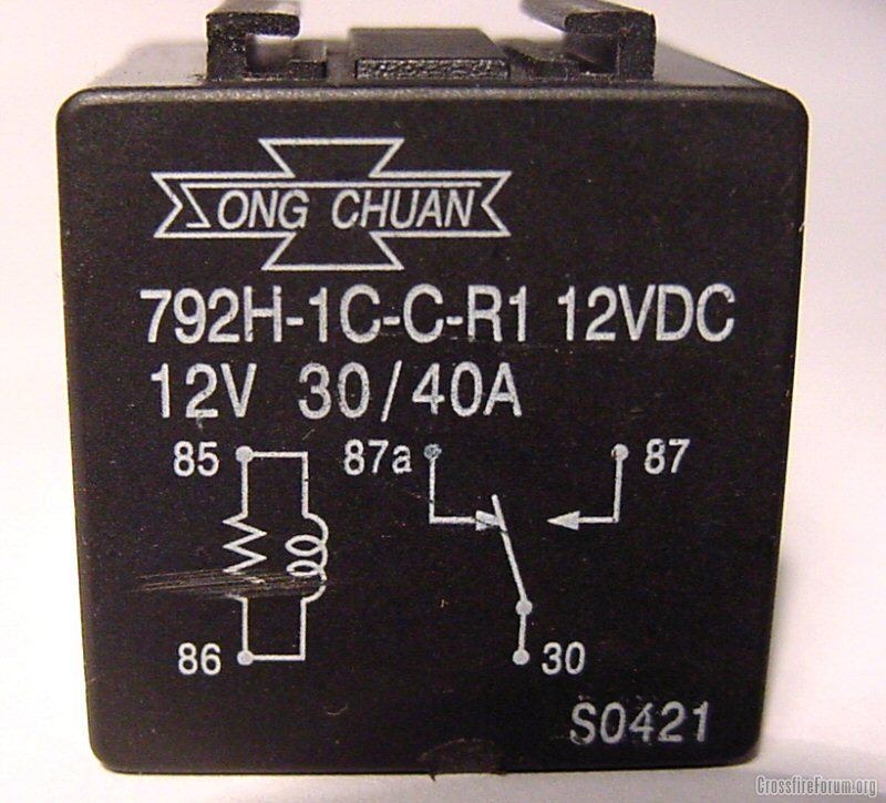

There is an easy way to do this without going into the cabin. Use a standard 5 pin relay (we refer to them as a bosch relay). Connect your angel eyes to a fused battery source, and run them through the "normal closed" contacts (30 and 87a) of the relay. Splice the coil circuit (85) to your headlight wiring, (86) to ground. I can draw a diagram if you don't understand.
That way when you turn on your headlights, the relay will engage, turning off your angel eyes. You are using the relay to turn off an item rather than turn on an item. You can get them in ranges from 20a to 50amp. Not sure what the angel eyes draw.

After looking over my directions I need to make one correction. You need to hook up the angel eyes to an "ignition" circuit under the hood. That shouldn't be a problem with the electric box mounted under the hood. If you don't use an "ignition" power source, they will remain on all the time. Sorry about that.
You can connect both sets to the same "ignition" circuit, just have one set bypass the relay to get the effect you are after. Be sure you have them properly fused for protection.

3 pictures showing the 'james1549' set up.
Outer rings on from engine start , All 4 rings on with the side lights , Inner rings stay on when the headlamps are switched on .
Cheers All
