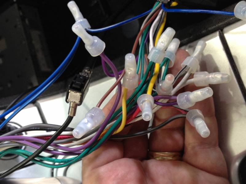

The blue or blue/white of the harness is the amp remote. If you are running subs then that wire goes to your amp remote, otherwise useless and not used. I am only showing one on the schematics I pulled up thats blue though, and it says blue or blue/white.

Another thing that may help is if you take a picture with the wires in your hand spread out. Right where they connect to the harness.

Anyone have an email I can send it to I can't post pics from my friggin iPhone lol technology is kickin my **** today

Sent both pics sorry best I could do with what I have

Do you have a amp and subs hooked up also? If not then the blue wires according to the diagram of the harness should be unplugged.

Scratch what I just said.
https://www.crossfireforum.org/forum...wire-help.html
Maybe this will help. They said the 2 blue wires go to the remote.

Goy it! There are 2 solid blue wires connected to the speed sense if u connect it it will be constant power manual switch is locked out if u disconnect it works like a charm

So everything works now???
Old Feb 2, 2012 | 03:48 PM
Phil1480's Avatar
Joined: Feb 2012
Posts: 14
Default Re: Spoiler acting strange
Yes everything is golden right now
