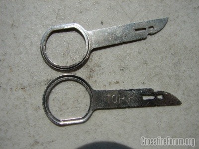

I have checked the fuses under the hood on the driver's side not sure where the fuse for the amp is. Do you have to have special keys to get the radio out
You need these. You can find them just about any good auto parts store, or even Wal-Mart.
