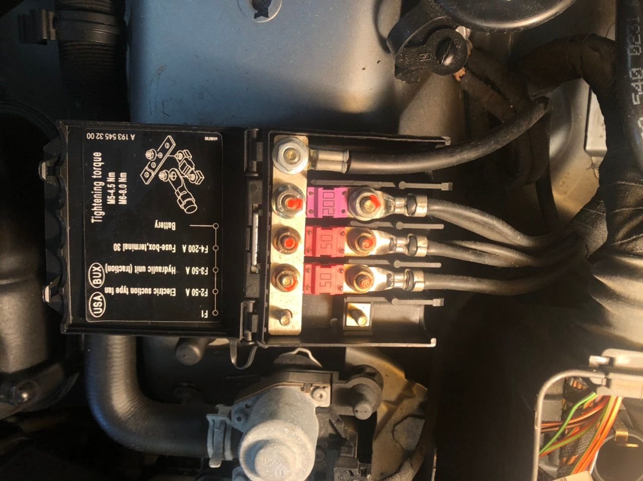

Thanks, I have access to both sides of the grommet. While it does not look like you can added a wire to the positive battery terminal, I did find this. Can anybody tell me what type fuse this is. Fuse spot #1 is free and I would love to buy a fuse to fit it, but I just don’t have a clue about its name.

A simple google search found this:
https://www.autohausaz.com/pn/611383...yABEgIVpfD_BwE

I should have looked harder myself before asking, but I guess its a MIDI type fuse. That helps!
