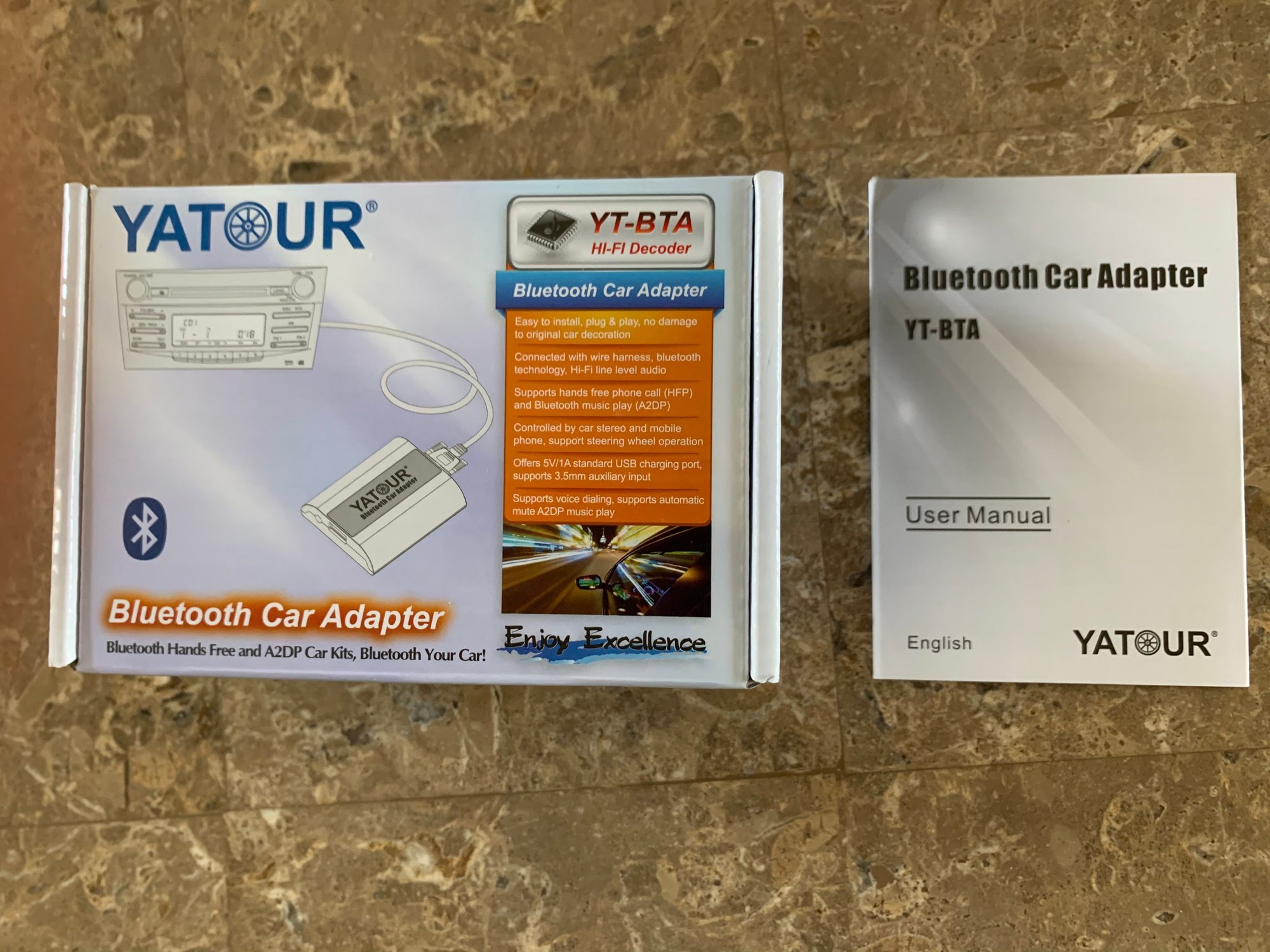

All I can say is thanks Toolman!!! I ordered the YaTour Bluetooth adapter Model YT-BTA BEK (Becker) for my Infinity NAV head unit and it works great! Pictured below in the unit, $94 on EBay. I ordered on 1/19/21 arrived today. Took about ten minutes to install and I’m up and running with Bluetooth connectivity from my iPhone. The YaTour has a 3.5mm Aux Jack and USB inputs as well as a Mic input I assume for phone use. The key to this YaTour is it’s use of the CD Changer input plug, that includes the Aux input left/right/Grd wires on the blue connector and the six wires on the green plug that allows the YaTour to emulate a CD Changer. You use the radio CD button to access the YaTour and the display shows CD Track1, while it is Bluetooth connected to you phone. The radio next track button does advance to the next song from iPhone. My Primary music input is from Pandora, so it becomes very functional from the iPhone. The YaTour cable is about 36” long and could be wired to placed the 2”x3”x1/2” Box in your armrest storage where the Aux/USB/mic ports would be accessible, which I plan to do. Right now I just placed the box in the space behind the Radio.
https://www.ebay.com/itm/Yatour-Blue...72.m2749.l2649
Thanks again.... TOOLMAN! I owe you a Beer 🍺
