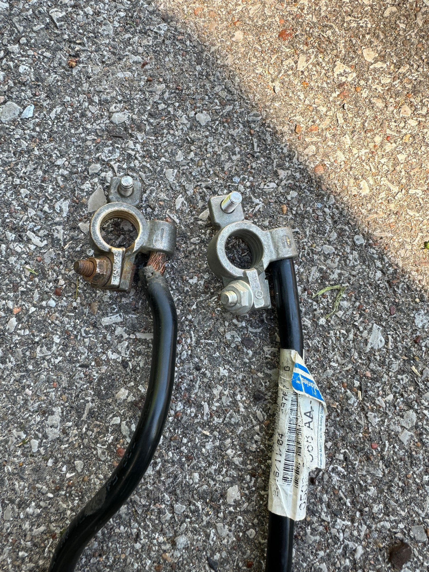

What's strange is that the clasp spins around the ground terminal even when it's tighten up.
This is likely to be the issue right here
Your post clamps MUST be tight enough that you CAN NOT turn them with your hand when fully tightened

Yes, this is correct. I feel stupid now thinking about it and hopefully once the replacement comes in it should resolve my issue. At least I will learn an important lesson! Thank you! I will update you on this.

I agree. Now thinking about it I feel pretty stupid. I know it should be tight, but the clasp isn't clasping anymore even though it looks like it's making contact. I will send an update and hopefully I can get back on the road once I receive my replacement OEM from eBay. I learn new things everyday thank you to y'all!

No need to feel that way.....I hope a new clamp will tighten securely for you
Many years ago on my Coupe, I put 2 small pieces of metal wire cut from a paperclip between my clamp and the post (opposite sides of the post) to fill the tiny bit of slack I had and it tightened securely and I never had an issue after that

Hi All,
Finally got the replacement OEM negative cable. The car is happy now. I can't thank you guys enough for the suggestion.

Originally Posted by crobards
Hi All,
I hope you all have a great weekend!
That looks like a Chrysler sticker. Did you buy a Chrysler one instead of a Mercedes one that is usually less expensive????
