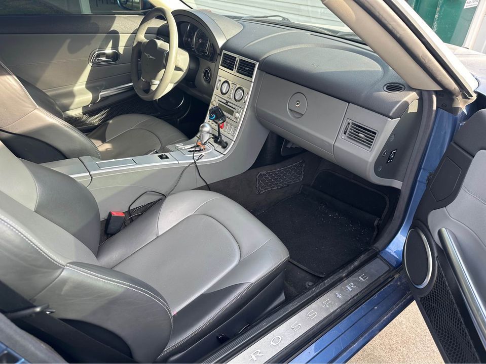

Well looks like Father time, I'm sure, has taken its toll on the OEM speakers.. I noticed on my just purchased 2008 Coupe Limited, the door tweeters are out and atleast one of the two rear subs are out.. Are replacement difficult to find and any one know the impedances? I might be taking the door panel off to make it easier to apply the door window tint.. I should get some replacement speakers ready.

Yes, good advice, I pulled the rear subs out and tested them and tested the amp ch outputs..i had to fix a loose wire post one one, but are good, and so ordered surrounds for them as the are shot..and ordered a used set of OEM tweeters which tweeters and surrounds might be here tomorrow, so I'm be pulling the door panels to look over the mid's surrounds, , and I'll install the tweeters, 270 ohm caps when the arrive, and re-tint the two windows while the panels are out of the way..last owner installed 20%..geeze

I did fix the rear subs, tested and remounted them.. much better bass in the cab now... My tweeters tested good, but neither is working..I was worried the floor amp had bad tweeter outs, but I read that they are (wiring) paralleled to the door speakers, and those were good (didnt have to repair the surrounds either) but I'm wondering if the connections are corroded and where the Tweeters "tap" into the Mid bass door speaker circuits as the wiring from the tweeter appears to migrate from an independent path (until it disappears in a neatly bound group of wiring.. In the doors or under the passenger floor(?)
