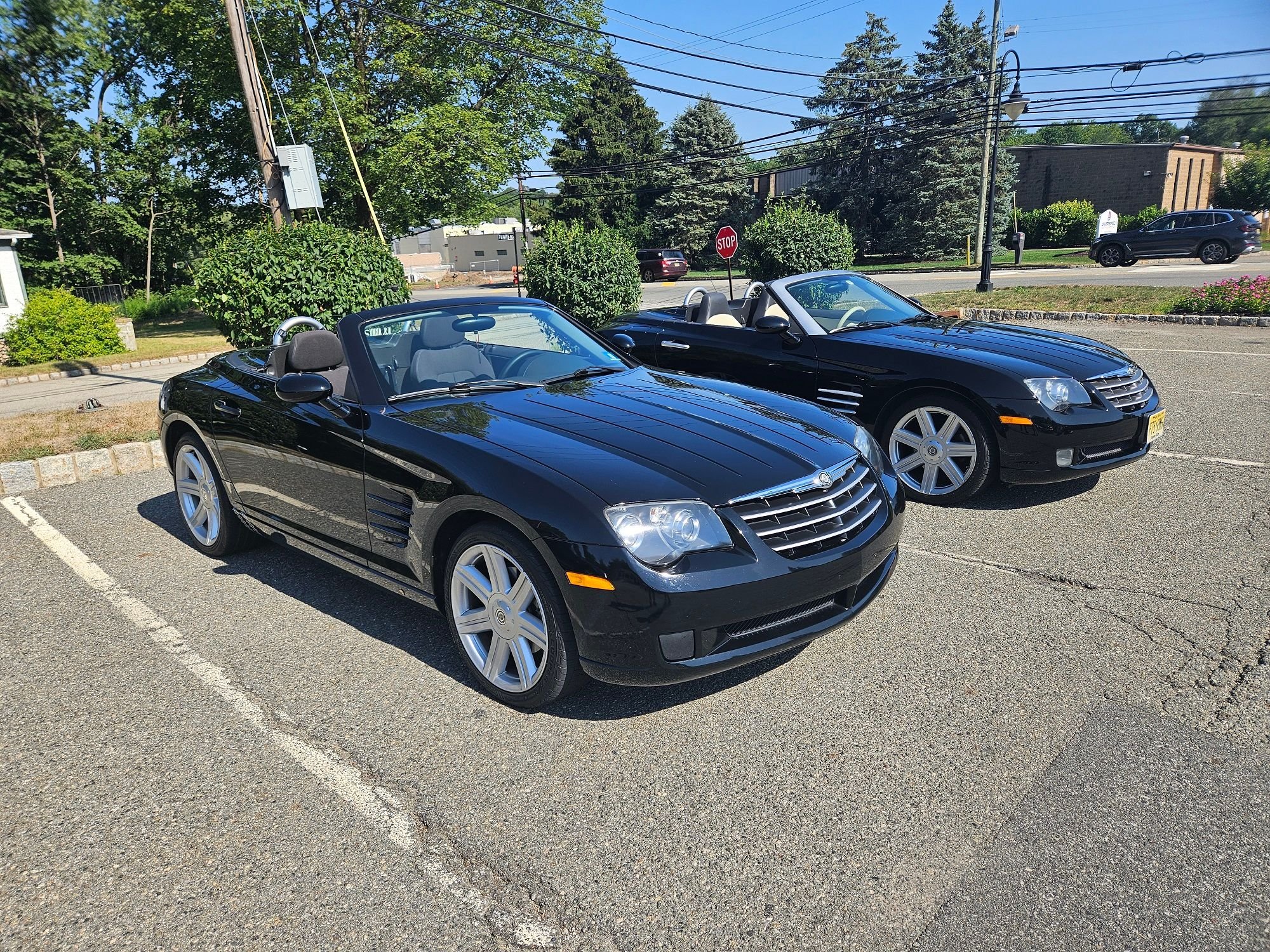

Old Oct 17, 2025 | 01:30 AM
Posts: 3,180
Likes: 1,726
Default Re: 2006 crossfire radio?
The car closest is a base model (all black). The other is a Limited (silver trim).
Old Oct 19, 2025 | 09:00 PM
bossman4's Avatar
Joined: Jan 2004
Posts: 81
Likes: 23
From: Michigan
Looks like the base model. Just a head unit in that car and no amp or back speakers. I ended up putting in a digital single din head unit and installed new speakers in the back. The latest single din units fit well (Walmart at $150) in the slot and have android auto and car play. Need to run wires to the back and new speakers since they don't exist in the base model and a backup camera if you want. There is plenty information in the forum on the latest installed uniots.
