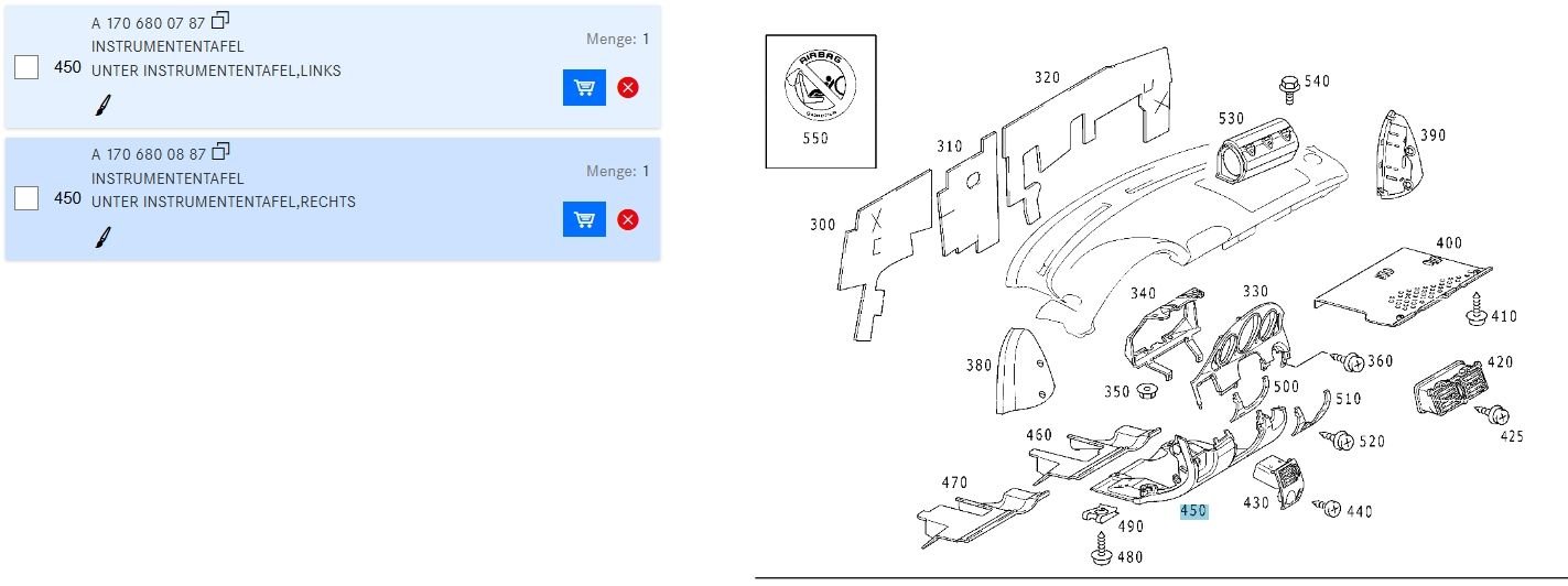

I have a request.
Since the mounting brackets have come loose, I'm looking for a plastic cover (possibly a used one) that covers the steering column and electrical components above the driver's feet.
It was unscrewed and lowered during the work described in this thread; it's also visible in the photo above.
Since I don't know the English name for this component, I don't know how to search for it on eBay, for example.
Can you help?

I think this is what you are looking for. Use this for your search.
CHRYSLER CROSSFIRE KNEE BOLSTER REPLACEMENT
Ensure that it is for a left hand drive car which I think your car is by the pictures.
Several are available on EBay in North America but that probable won't help you with shipping charges so high.
Jim

I found that probably this MB item number is A 170 680 07 87:
https://www.ebay.pl/itm/298223382716
Tomorrow I will try to find this item in MB shops in Poland.
I'm also considering welding this plastic cover - the upper right handle that holds the cover in place has broken off.
I also found the MB number A 170 683 03 26 of this item:
https://www.ebay.pl/itm/206196009798

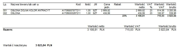

I received a quote for these two parts from the MB store: $1,060!
But unfortunately, Mercedes no longer sells them.
So, I'm left with repairing these two parts by welding plastic.
