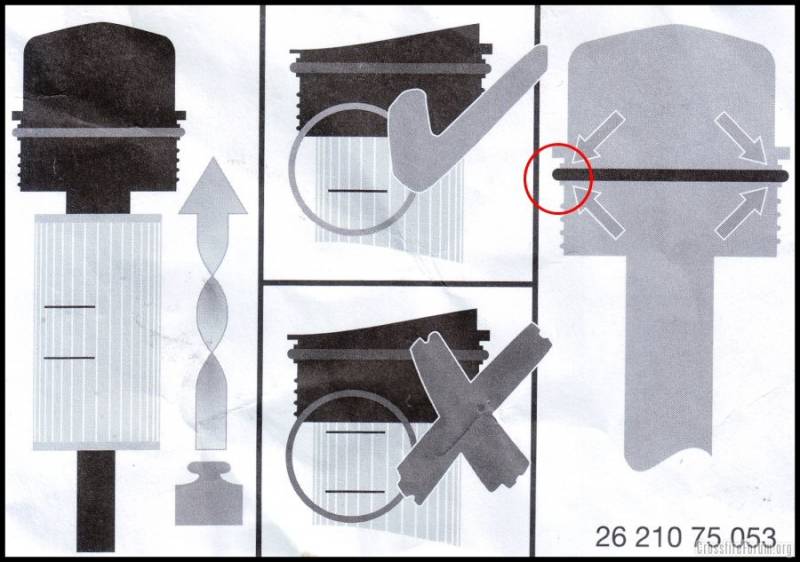

The last person that put your filter in, placed the oring improperly. Common problem I am seeing. I would suggest to replace the oring in question. However, you may be able to reuse it to get by until you get a new one, provided it did not tear it. See the red circle in the diagram below. Also be sure to lubricate the new installed oring with oring lube or clean engine oil.

Your cap may have a crack in it, but it could be the "O" ring too. I have heard that sometimes they will run for up to 1000 miles and then start leaking, so always check it. Most of the time they never leak, but something is not right. Make sure the filter is seated correctly ( see the two lines, one will disappear under the edge of the cap). Send me a PM with your e-mail address and I will forward some pics of the grill. I bought it from SRT6 on the forum. He can send you a bunch of pics either in Black, While or Chrome.
