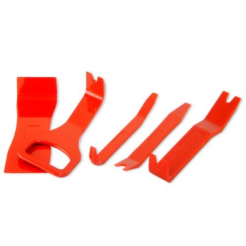

Many years ago I bought a kit similar to this and it works wonders for jobs like this:
http://www.amazon.com/No-Scratch-Too...8118132&sr=8-1
