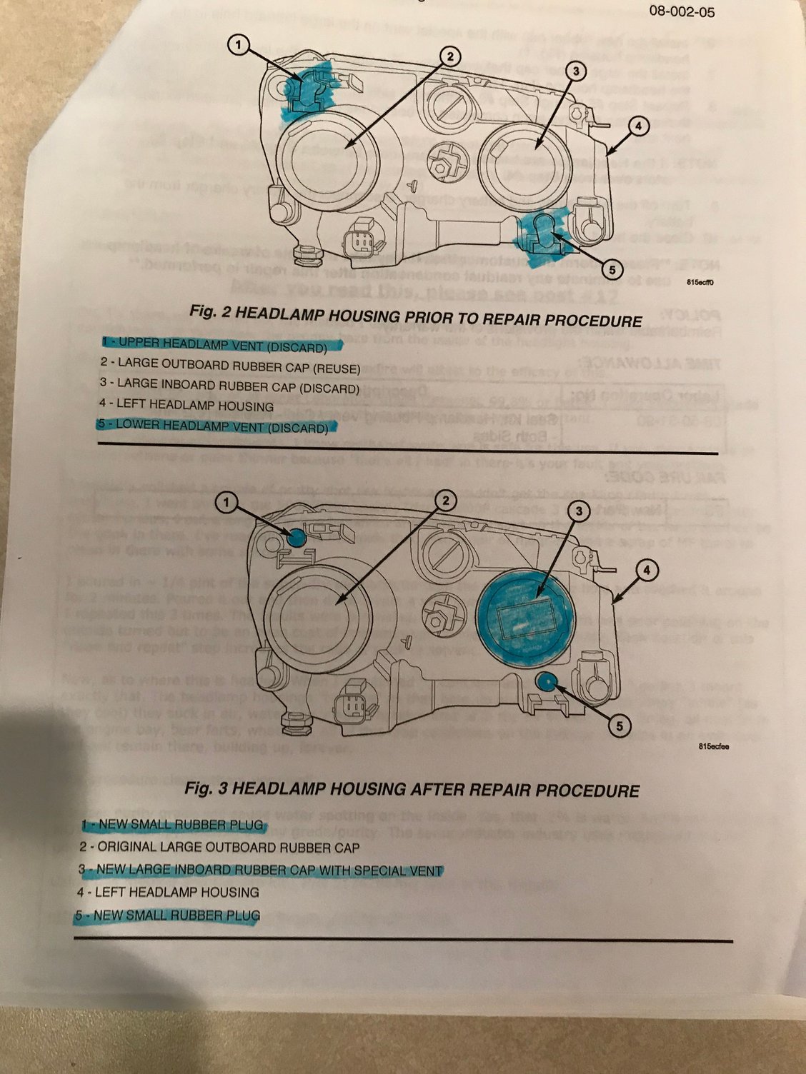

Has anyone been able to find this replacement kit P/N 5174786AA?
I finally scored a Crossfire I have been looking for 12 years now. 2008 Crossfire in Aero Blue with 13k on it. Right away it started showing the issue. The previous owner drilled a hole in the side of the drivers side headlight trying to solve the issue of the moisture building up inside. I would really like to buy the kit and solve the issue but no one has it any more.
Old Mar 20, 2021 | 07:29 PM
  #38 (permalink)
Likes: 648
Default Re: A lot of Water droplets visible inside headlight lens
The last post before yours is nearly five years old, the kits are no longer available.
You can see threads that explain how to dry the insides of the lights. Some units leaked around the sealant, some may have been missing a plug. Some believe that water was diverted into the unit. The worst I have seen looked like an aquarium minus the fish.
Add a picture of the rear of your unit, maybe it is missing some thing. Fill up the hole that was added.

I could not take pictures of the headlight but I am attaching the pics from the service bulletin. I marked the top pic to show what I am missing which is probably causing the droplets to build up. The bottom pix shows what I need to fix it. I find it very strange that this is only on the drivers side and not the passenger side.
Old Mar 29, 2021 | 11:28 PM
  #40 (permalink)
Likes: 648
The bottom picture shows what it should look like. It is one half of the kit required to rid the lens of the condensation problem.
The top picture shows you are missing the two caps and the rubber lens cover that should have that very fine mesh window on the back of it.
